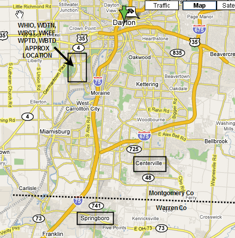

The Dayton locals transmitters are actually near Springboro/Centerville on the Montgomery/Warren/Butler county boarder.
No, they're not. They're hardly close to Centerville, let alone Springboro. They're in "southwest" Dayton or so. See the attached map.
Problem for Camden is that the towers are East-Northeast from there whereas Cincy's towers are Southeast. Probably a 90' separation.

I know there is an antenna farm at the top of the hill as you crest over the rt. 73 interchange, south of I675 and that is where I thought the towers were.
I can't say that I recall seeing any towers in that area. Next time I'm going that way I'll look though.
Went south towards Cincy yesterday and I didn't see any tower farms other than what appeared to be cell-phone towers. This was from the Dayton Mall exit (first exit north of I675) to past Middletown. Some of the towers didn't look like the typical cell-phone towers but they weren't high enough to be TV broadcast towers either though.
I'll be going up to UD arean and/or Nutter Center in the coming weeks for tournament Basketball. I'll look and see what the heck I was thinking about!

As you pass the I675 overpass (when you go to UD Arena), you'll crest a hill near the St Rt 725 exit. When you're there, you'll have a perfect view of the Dayton towers to the north and slightly west. The towers are still a number of miles north and in fact, are almost due west of the UD Arena area.
