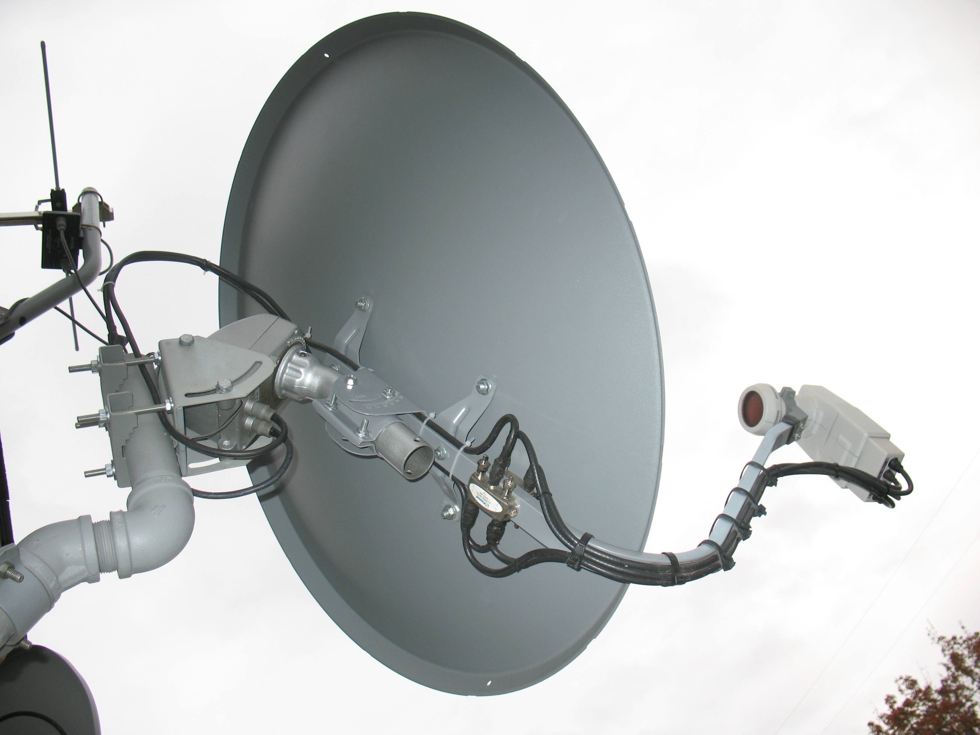

Typically I place DiSEqC and 22KHz switches at the dish. I use quality Gilbert compression fittings and put a cap full of dielectric grease in each fitting before attaching. Most switches are weatherproof, suitable for use in all but the harshest conditions and can be nylon tied to the elevation bracket or the mast without protection from the elements. I prefer to place the connections and switches in a weatherproof utility box mounted on the mast or ander an eave.

I have a pair of cheap DiSEqC 1.0 switches mounted to my Winegard2076 since '05. They have never given me any problem in Montana winters.

Chadg2, have used 2 Chieta DisEQc Switches out at the Dish for DisEQc commands on 2 Dishes in 30 degrees below zero weather for 6 years with no problems.
The problem with installing indoors is that, with a motorized system, you would want the switch to be installed after the motor (between the motor and the LNBF) to prevent motor current from burning out the switch prematurely. This requirement makes installing switches at the dish site almost a necessity, unfortunately.
Enclosures are probably the best protection, however in the 7 years I've had dishes up, my switches have always been exposed to the elements. Funny thing is, my original DiSEqC switch is still functional, even though the back is totally covered in rust.

I have had my 4 port diseqc switch outside for 2 winters and the temp got down to about -5. I don't have it protected either and it still works much to my surprise. It is suspended in midair however.
I am using a Chieta and a Viewsat diseqc switch. The Viewsat one is connected after my motor and connects to 2 outputs of my QPH-031 and a side mounted lnbf on the same dish. The Chieta connects to the same lnbfs. They have both been exposed to -30 temps with no problem. My motor slows a little in that cold, but still moves. I have only lost 1 switch and that was from a lightning strike that also took out some caps on my Sonicview 8000.
