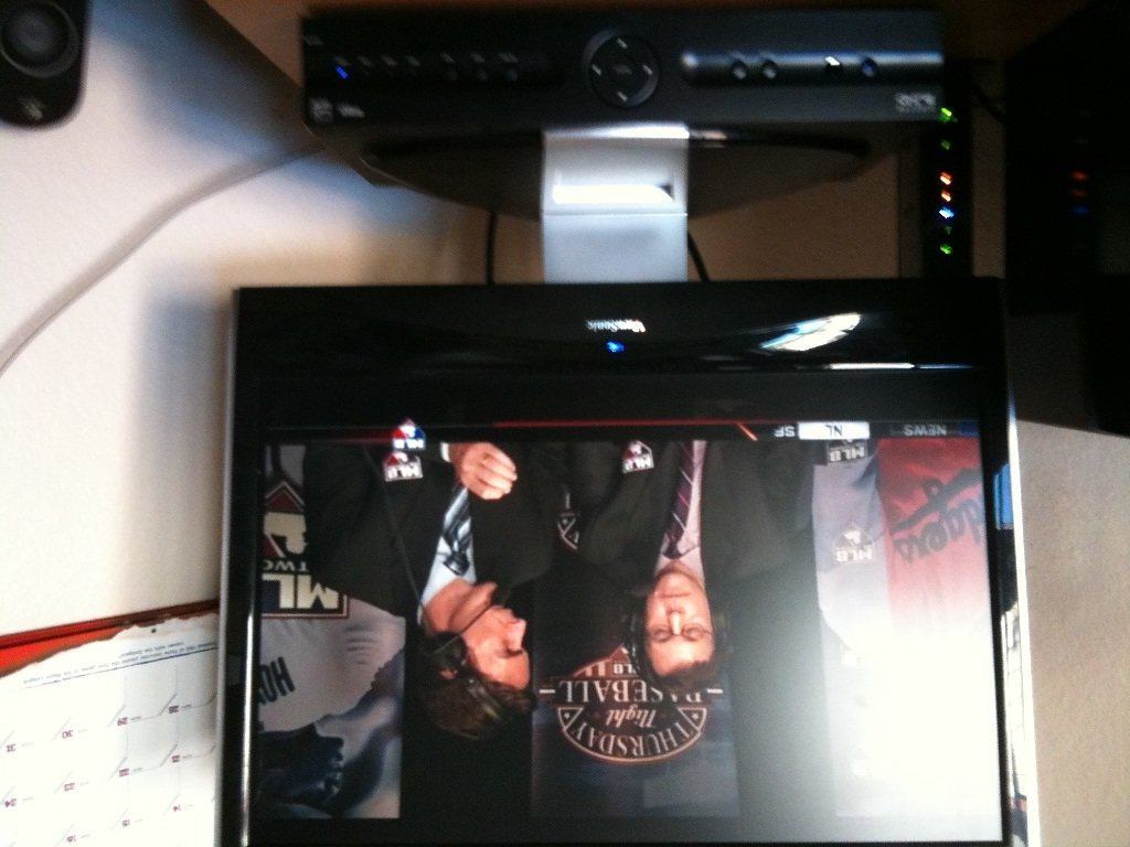

Yes it will. I had one hooked up through component video and composite audio on a 24" sync master until the backlight capacitors went out on the monitor. I currently have one hooked up to a 22" viewsonic through HDMI video and audio to stand alone speakers.

Here is a pic I just took a few seconds ago
