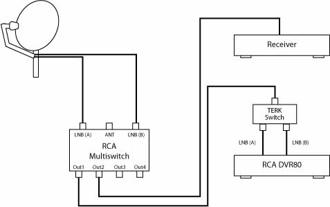

Thanks, ShadowEKU. That's kind of what I was thinking. I went at lunch and bought a multiswitch. Here's a diagram of what I understand should be done.
attachment.php
Will this work? Has anyone tried this setup?
attachment.php
:yikes If that config works at first, don't be surprised if it quits working after a while... The problem is that splitter you have inline before your DVR. They simply don't work correctly with a DBS signal. I don't know the answer as to why... I'm sure some of the real techies here can answer that. But I've been down this road before.
There have been tons of people, including myself that have tried to install a D* dvr without running another coax cable from the dish's switch, but trust me, it is simply not feasable! If and I do mean IF that set up works, the splitter will either die or the irregularities in voltage and signal strength will eventually cause damage to one of the other components in your setup. (Let's just hope that it's not a reciever!)
I spent an entire Sunday running cable around my house and through my tiny 'crawlspace like' attic and I'm very glad that I did. The only thing that I would do differently next time is that I would have an installer do it instead of myself! :smug
You cant do it because of the different flavors of voltage. You change the flavor to get a signal from the appropriate LNB (i think). With 2 tuners on one cable changing flavors you get stuff overriding and cancelling resulting in intermitant signal and half your channels not working.
Thats the 'i know just enough why it doesn't work' version.

yeah i dont think that would work. theres no way around running 2 lines to the DirecTivo... i think you will have to use 2 lines from the multiswitch for the directivo and 1 to the standard receiver.
Referencing your diagram: What you need is to eliminate the Terk switch splitter at the DVR, as it is not meant to do what you are trying to do with it ! Go directly from output 1 on the RCA multiswitch to LNB-A input on DVR with that existing cable,then run another cable from unused output 3 on the RCA mutiswitch directly to LNB-B input at DVR . If you cannot run the second cable from the output 3 of the Multiswitch,it will not work correctly and you will have to be content to only use 1 tuner on the DVR.

it will not work. trust me . if you are getting signal it is only on the odd (18volt) transponders. just run the new coax and do it the right way.
.....bob

Okay, so cr0mag was right. It works intermittantly. So I guess I'll try to run more coax somehow.
Thanks everyone for your input.
