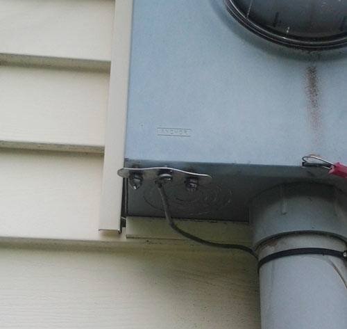

Last night lightning must have come through the dish and cable wires and fried our boxes, our tvs, and a receiver.
I went outside to check the connections and saw that the dish is grounded to a meter lug.
Is this proper grounding?
Probably not, but it wouldn't make much difference if you did get hit by lightning. You should ask your local electric inspector what is okay for your area. I would Directv and have them come out too. If the grounding isn't correct, they may cover replacing everything. It doesn't hurt to ask.
It's correct. NEC code is what we follow and if the ground wire is covered then we use a lug just like that
If you get a direct lightning hit, there is NO ground that will save your receiver and TV. You should be thankful that your house didn't burn down!
That is a perfectly accepted NEC code ground.
Even if it was not grounded. That is an act of god and Directv nor the installer have any liability. They would not be resposible to replace your tv's or anything else. You need to call your home owners insurance and get the ball rolling.
The bond is good, but hard to tell without other pictures of the dish and ground block......... There should be a messenger wire with green lug at dish to ground block then from ground to meter.

If it's properly grounded then I agree. If not, I'll bet they would rather replace the equipment than have the exposure of a lawsuit for not following the code, especially if it's SOP for the installation company.
It's properly grounded with that style of connection, they have been out for years.
Everything looks good to me. Sorry to hear about your electronics however.

Yes. That is an acceptable NEC ground.
Look, NOTHING will stop the current of a lightining strike. NOTHING.
The purpose of grounding the system is to disperse any static electricity built up at the antenna. This serves only to lessen the potential of a charge building at the antenna that MAY result in a strike on the antenna itself.
The other purpose is of course to limit the possibility of liability on the part of the installing tech and the satellite provider itself.

There is no IF here. That type of ground meets the specifications of both Directv and Dish.
NO..Local codes CANNOT supersede the NEC. A local ordinance may have in it an additional requirement to a particular code, but MAY NOT supersede or undermine the NEC. That is why there is a NATIONAL code.
You are NOT accurate here.
I did this stuff for 12 years. I held all required certifications and have forgotten more about this stuff than you'll ever know.
You should stand down now.
The NEC is implemented locally, and variations are not uncommon.
Correct. Local codes may not replace or undermine the national code.
In other words. The NEC is the standard. The local code may require additional measures that exceed the national code.
For example. State or national building codes do not require 'hurricane clips' in the roofing structure where rafters tie into the wall framing. Local codes in certain areas require them.
