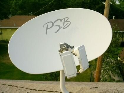

They used to make the below dish, I have two of them, one brand new the other slightly used, they point at G4R at 99w and at the DirecTV 101w satellite!
Another thing you may want to try is a 30" dish with a dual LNB bracket that holds the second (DBS) LNBF, I always use the weaker KU band LNBF in the focal point and the much stronger DBS LNBF on the side, this may work for you!
http://www.dmsiusa.com/ds2076.htm
http://www.dmsiusa.com/2_lnbf_bracket.htm
With this dual bracket the LNBs can be set at any distance apart, within reason, but may work for you, good luck!

Your welcome, just trying to help. You never said where you were located : )
direclinks said:
How can we combine Satellites 99 and 95 on the same dish, or Satellites 91 and 95 on the same DiRECWAY dish. We use Satellite 95 for DiRECTV Latin America version, and 91 or 99 for DiRECWAY.
DiRECLINKS
you can band clamp the two together....pretty ghetto but it works :)
