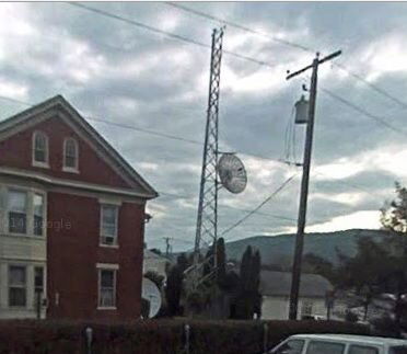

No, I would never want to breach any etiquette. It would be awesome to be able to use a C dish, but as drunk247 points out, it'd be challenging in this area. Attached is a photo of the dish and tower that I used to use.
Well, I suppose you can't always get what you want. I kinda wish I knew about FTA and such before I bought a house...the house came first. Next place I live, though, WILL come with clear LOS to everything.

It appears that the ground mounted BUD is 'looking' towards a lower elevation satellite than the one on the tower. (???)
