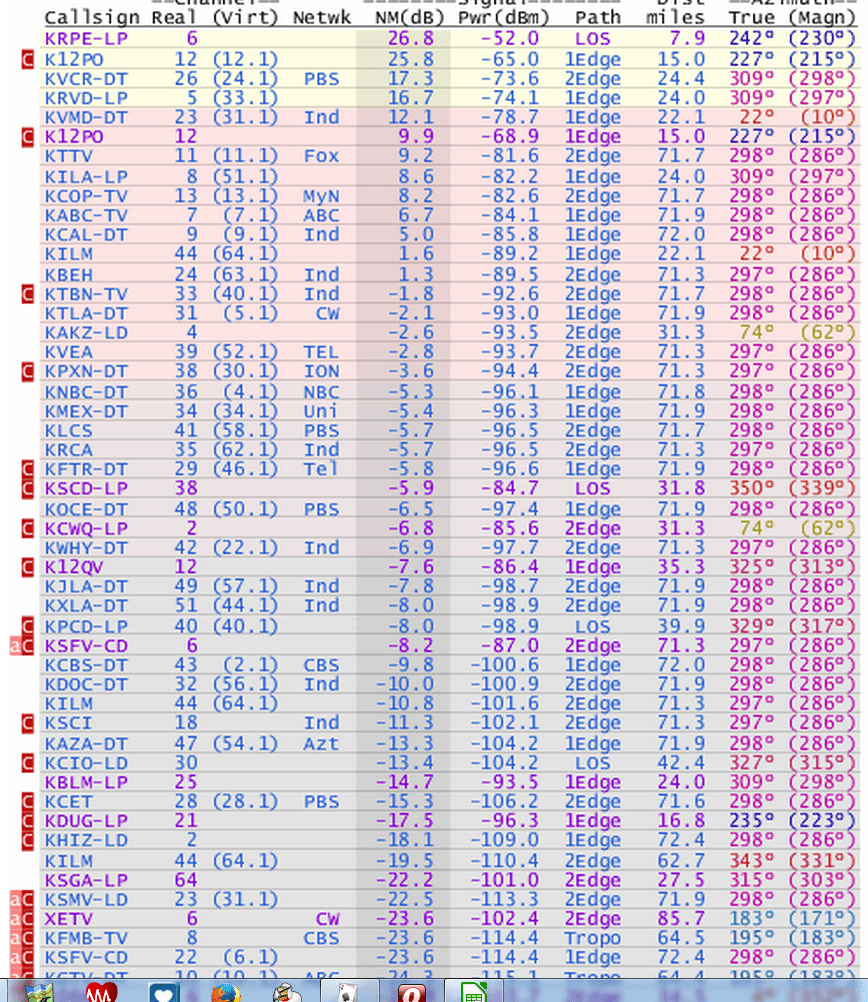

When I look at TVFool I see that I am 72 miles from the Mount Wilson Transmitter farm for Los Angeles I have weak signal strength and 1edge or 2edge designation on most channels.

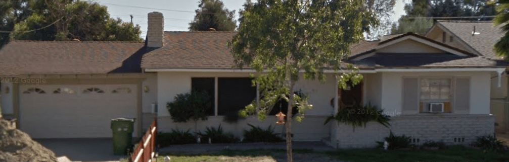

Post your tvfool.com so we can see what you are living with. Can you post pictures of your house? What type of TV's are you connecting?
Run the TVFool report using the mapping facility, there you can adjust height and see how it effects signal strength and if/when LOS is possible.

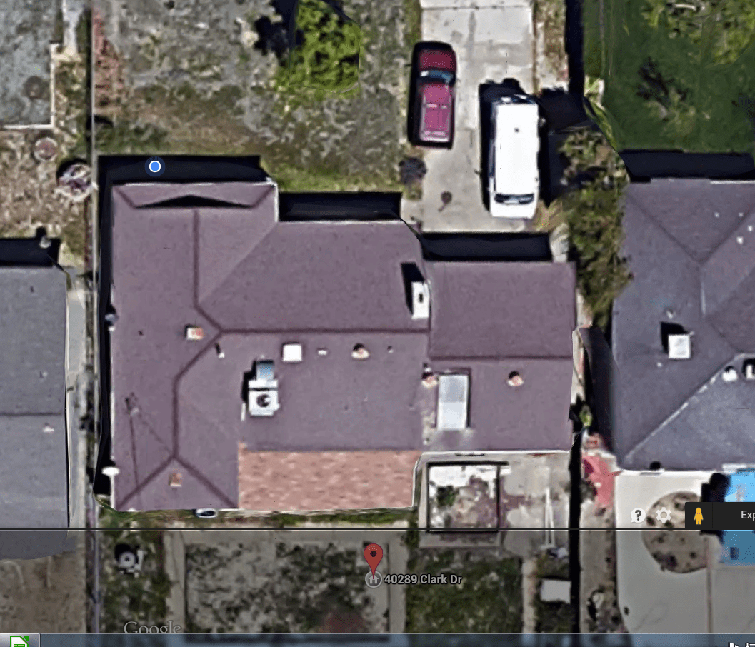

You can even see your house and put the antenna right where you want it when running a simulation.
Given that all but a few stations have edges to contend with and your best signal is projected at just over -55dBm, I'd say you're in for a fight. It doesn't help that you're kind of in a bowl from a multipath standpoint.
Finally there's the issue of channels coming from various directions.

The front of the house is facing north the transmitters ar west 298' which is to the right in this view the tree in the front yard was blown down in a wind storm. There are no trees in the direction of the transmitters.
In this view we are facing north so the transmitters are to the left.

Your chimney may be the best mounting location, the HD8200 that A Raine is using with a rotor may be the best fit. Your tvfool shows Low VHF/high VHF and UHF channels and very difficult reception. Good Luck.
