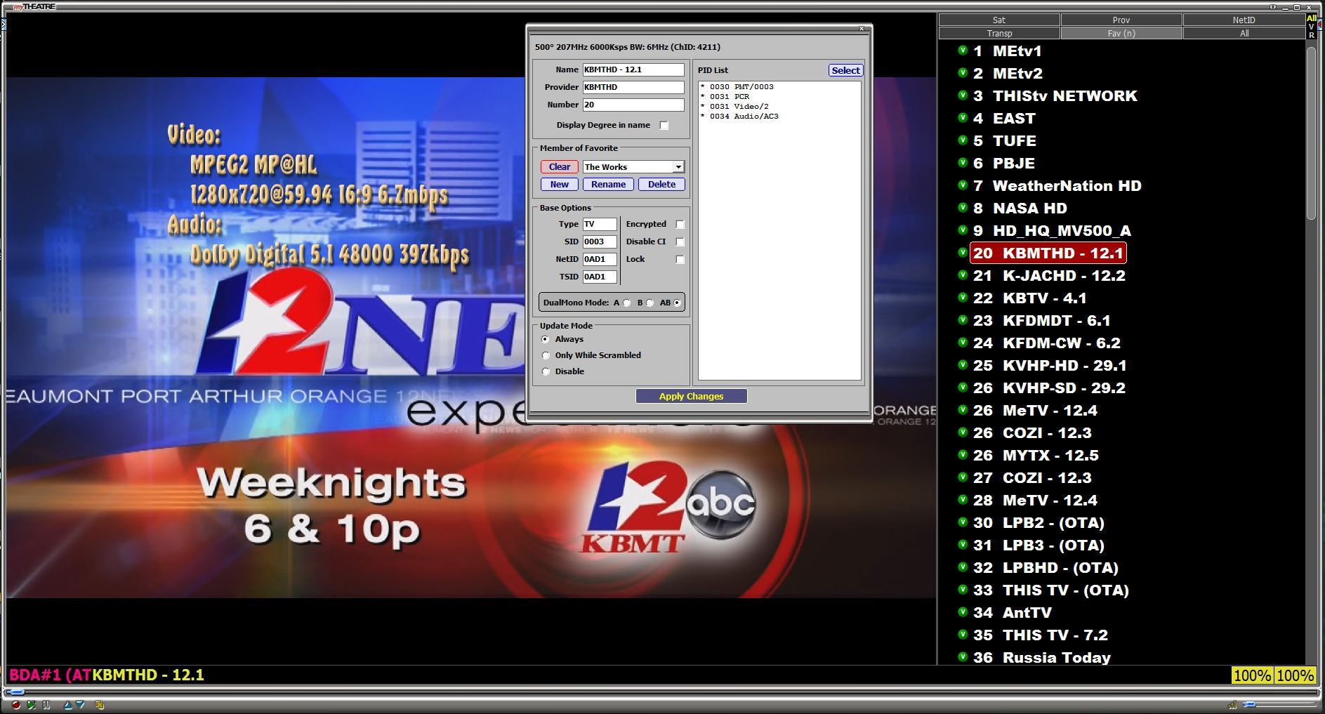

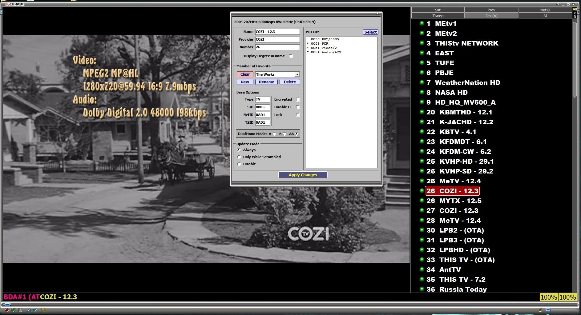

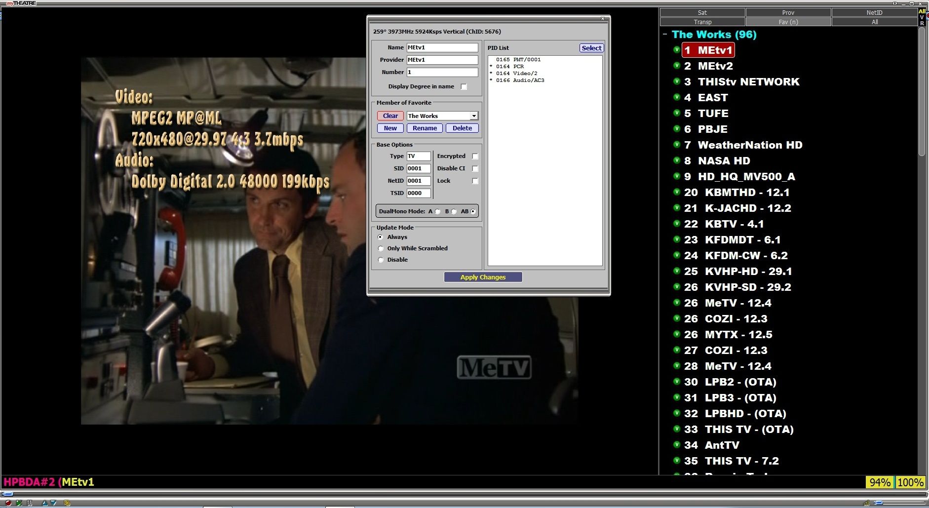

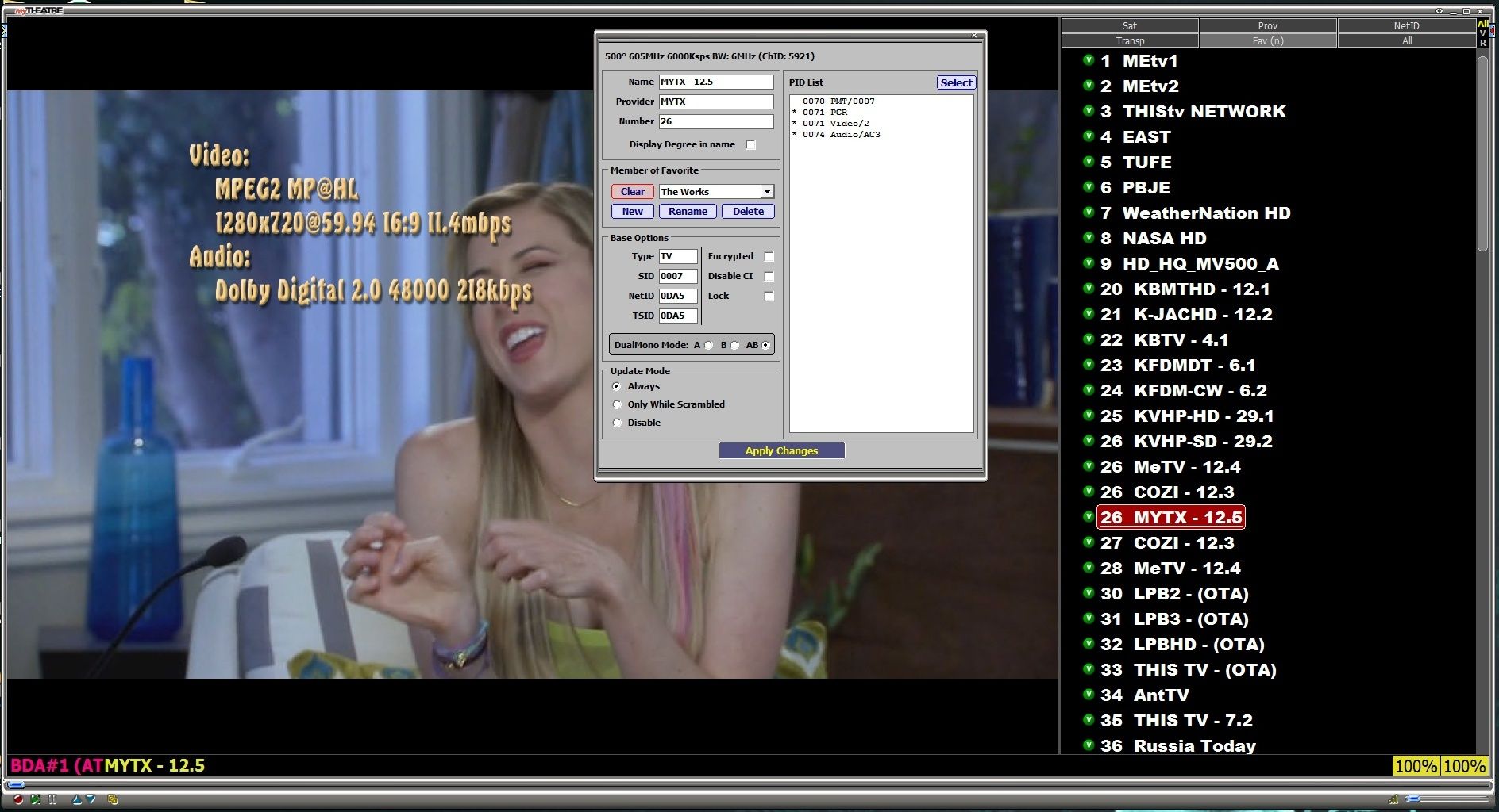

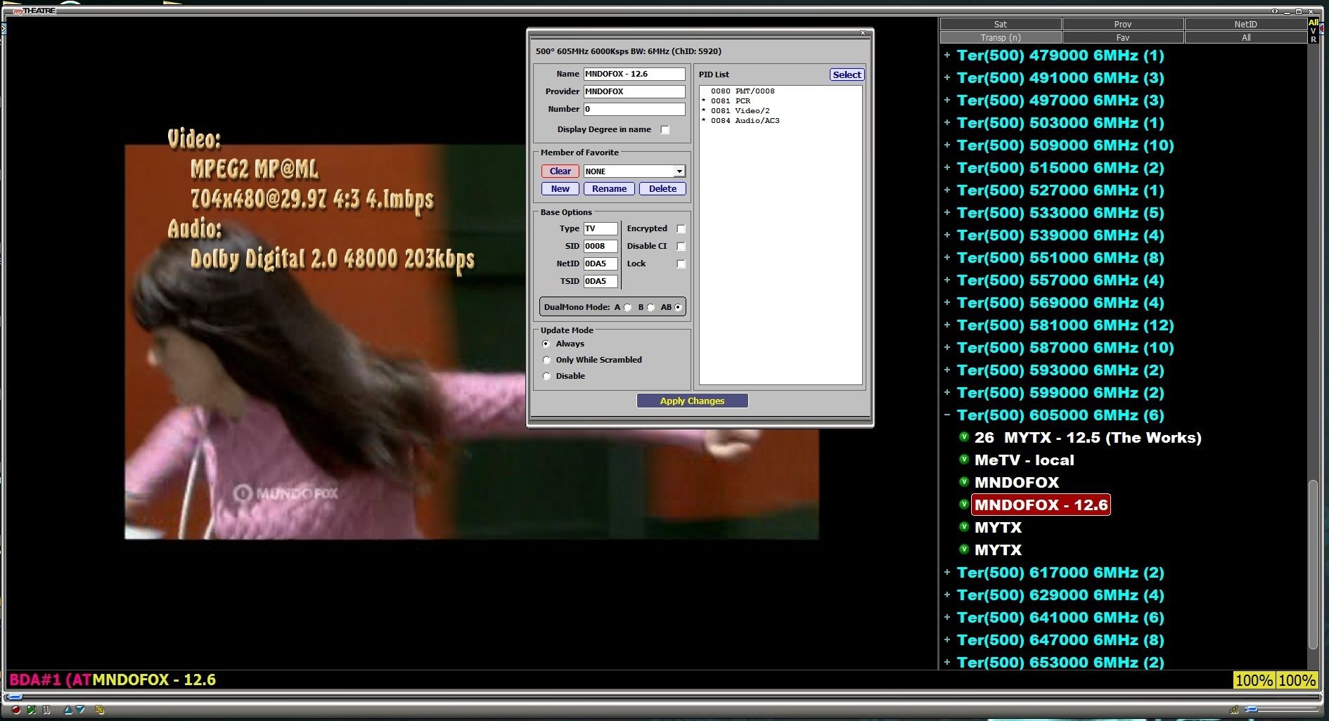

Ok, I think this may help verify what is what here in the area..
I took screen shots of info for each channel then lastly I took a screen shot of info from MeTV coming down from C-band, for the sake of comparison so people can see what they are doing at KBMT with compression and stuff.
(Pay no nevermind to my jumbled channels list on the right side, I need to delete a bunch of old junk from it.. :o )
The screens are self explanatory..
You can see all the SID/PID stuff, the frequencies, resolution, etc...
I have no idea what the Ksps means.. The mbps, I understand to some degree and on each channel it is wild.. 12.1 is lower than 12.3 ! 12.5 is WAAAAAY high! 12.4 is pathetic... Seriously, :wtf: is their methodology/logic here?
Also notice the signal strength and picture quality meters are all at 100%... This is brand new too! Previously I was getting like 96% on 12.1 and 12.2 and average of 68% to 78% on 12.3 and 12.4
the later channels would get very weak after 8pm and start breaking up. By midnight they would be so weak that it was impossible to watch them. Now they are rockin on full tilt after midnight !
I hope this info is helpful..

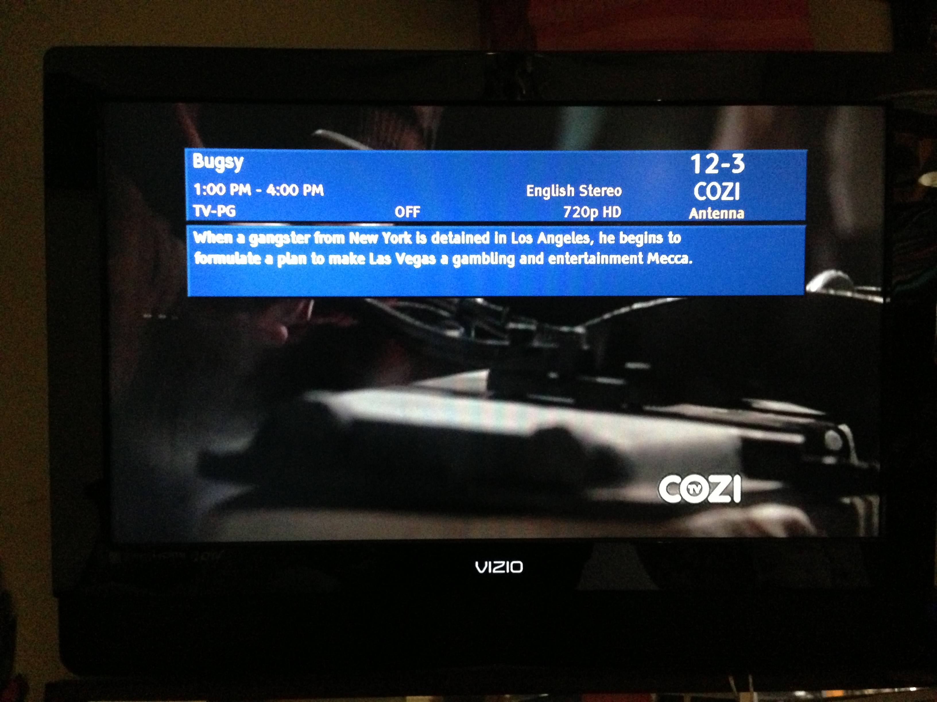

Anyway.. I've just discovered something interesting about COZI, they are running Bugsy right now and it's in 16:9 format ! And amazingly, it's not stretch/squish-o-vision.
According to the scan info I got yesterday they are broadcasting in 720p. I also just went and looked on my TV info and it too says it's 720p.
Despite that, you can very easily tell that the picture is highly compressed, low quality. :(
It says "HD" but it's far from it. Maybe they think only really old people in nursing homes will watch this channel in the day room 25 feet away from a 32" set way up on the wall..
Having a top end pro camera has ruined my expectations of pretty much everything.. (Forgive me for the quickie iPhone photos, I didn't feel like dragging out my real camera)
But anyway, hey, it's free TV so I'm not going to complain about it. Too much... ;)

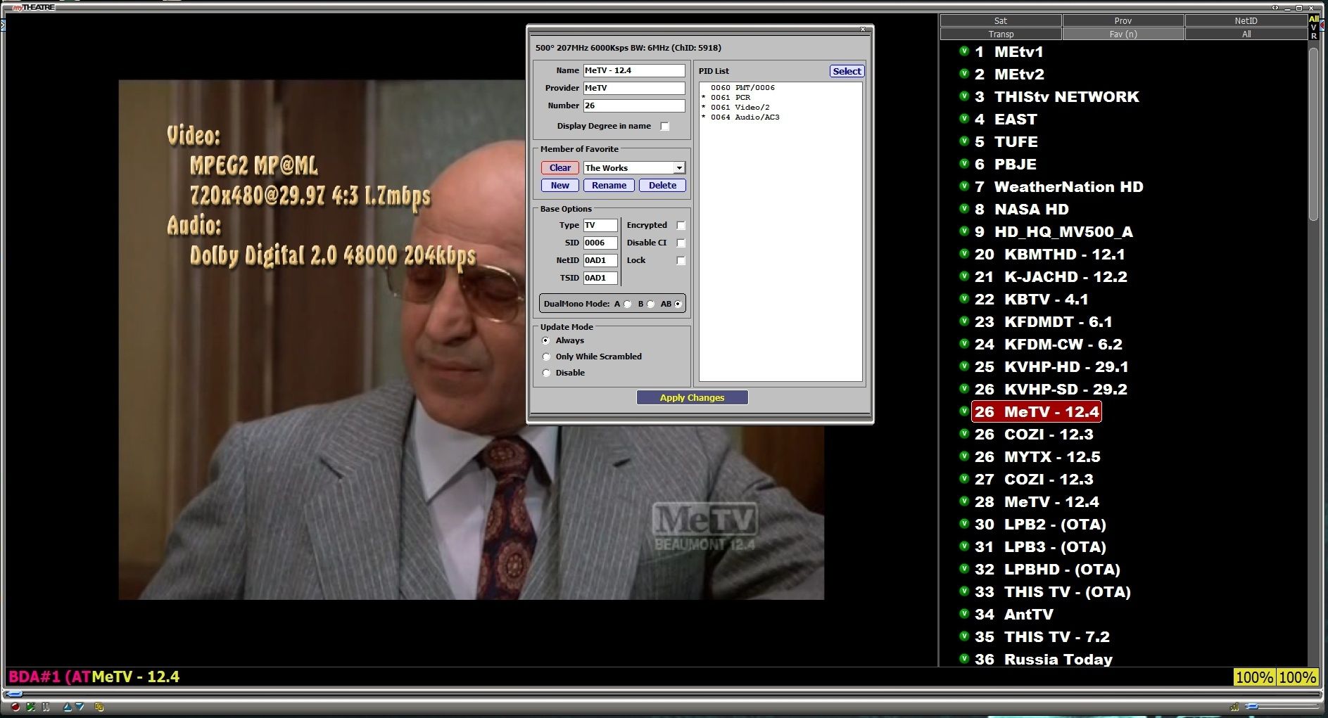

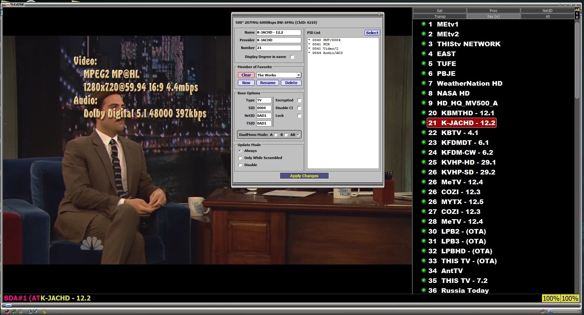

Cozi is 16:9 and 480i from the "master feed". From a thread in the FTA area when it first launched
Video format: 480i with 16:9 aspect ratio
so maybe KBMT is still working out the whole "moving Cozi to 12-3 and moving myTX to 12-5"
Seems dumb to run 720p on a channel that is only 480i to begin with

As for OTA, I noticed that even on my Vizio TV using an OTA outdoor antenna, the guide data for 12.5 is wrong.
12.1 through 12.4 are all correct, OTA. 12.6 I don't know, my Spanish is really bad except for menu reading.. :o
but 12.5 is showing the guide data for 12.3 and that's KBMT doing that!
I'm also getting TWO channels for 12.5 and 12.6, I assume they are the old 36 & 43 channels from the old low power towers. Not a big deal though because they apparently cranked up the power on those, I see a 20 point increase in signal strength on them.
Now, on my VIP211k tuner and using a splitter to feed the tuner and the Vizio via the same outdoor antenna, I am getting all the same channels via the same wire.
12.1, 12.2 and 12.4 all have correct guide data and this thrills me to no end! :happyd2:
12.3 (COZI) is showing guide data that SHOULD BE on 12.5 MYTX
12.5 is showing the infamous "Digital Service" for MYTX
Looks to me that the left hand doesn't know what the right hand is doing, at the cluster foxtrot dance.. If you know what I mean... :oneinacrowd:
