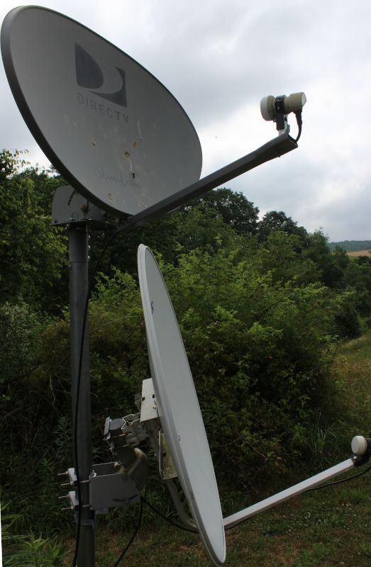

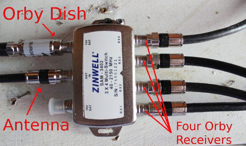

You should be fine if you use a multiswitch. I am driving four Orby receivers with just a modded DirecTV Slimline (mounted on pole above my motorized Fortec Star 90cm FTA dish) and a Zinwell SAM-3402 multiswitch. Also feeding my combined VHF/UHF antennas into the multiswitch and all four receivers can tune Orby and OTA channels just fine. :)
