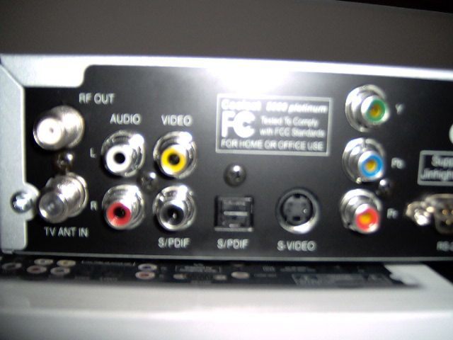

The first thing I noticed is the unit is slimmer than the 4000 and a little bit heavier. On the back were a set of audio video plugs, s-video, rf inputs & outputs, and a loop out for a second receiver. The 2 big features are the component outputs and BOTH a coaxial and RCA output for Dolby digital. I didn’t know if the unit would output AC-3 or not, but would find out later. The remote is a universal one and the main buttons are big. Don’t have to fumble around with this one : )

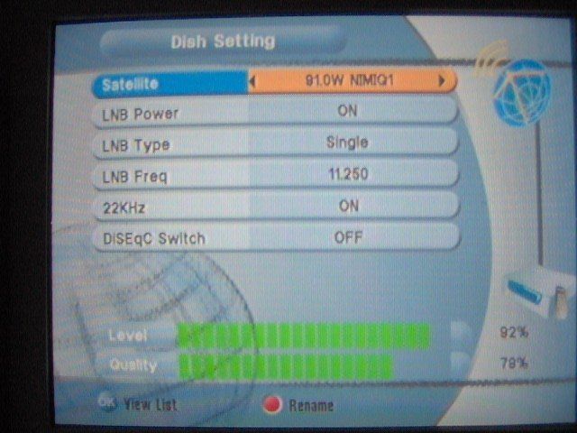

Once I hooked up my setup and turned the unit on, the first screen made me pick my language. After I selected English, it popped me to the familiar Coolsat screen. I selected installation and it asked me for my password. I learned with the 4000, there was a screen that you could turn off the “ask password”. I’ll get to that later. I selected Dish Setting and went in to change my LNB setup. Here is where you set up your system. I selected IA6 because it was my True South. The cool part is it has the new names of satellites (IA6. IA5, etc). Since I was using a regular LNB, I selected 10750 as LNB Frequency and backed out of this screen. I then went into the motorized setup. This is the one drawback of the Coolsat (in my humble opinion). I have used a Pansat for so long (and the Pansat allows you to set everything up in one screen) so I’d have to get use to the 2 separate screens for motorized. I selected a transponder that was active and scrolled down to motor. Since this was a temp setup, I used 1.2 settings and moved until I had a green quality. The neat feature when moving is you hold down the button to move but when it got near the signal, when you let go of the button, the unit seems to hone in on the best signal. You can fine tune if needed. So I went to save it, but here is a cool feature. You just have to exit (make sure to say yes to save changes). The unit STORES IT BY ITSELF!! No need to pick a satellite to store (the Pansat needs to select a satellite) and no having to monkey around with it–just back out. I could use the USALS feature, but I’ll do that once I set the unit up for full use. I backed to main screen and decided to do a blind scan. The Blind scan has lots of options. You can scan the whole KU spectrum (11.7-12.2) or just what you want. So if you know a frequency is somewhere between 11990-12010, just program that in. You don’t have to wait for it to scan the whole spectrum. But one thing I noticed is the blind scan is FAST! I changed the mode from “ALL” to “FTA” because I didnt want the scrambled stuff. The unit scanned IA6 and as it scan, it logs the channels. Other receivers I’ve used log all the Transponders it finds, then scans the transponders for channels. This does it in one step, logs the transponders and channels. I put it up against my Pansat for speed. I had both units on same satellite (SBS6) and blind scanned it. Both units picked up the same amount of transponders and channels, but the Coolsat scanned SBS6 in almost half the time as the Pansat 1500 I have used for 20 months. This is a major plus in my book as I do a lot of scanning for feeds. Once I was done, I decided to scan a DBS slot. So I went to Nimiq1. But much to my amazement, it wasn’t in there. Neither Nimiq satellites were in there. So I added it, as there are 20 blank satellites. So I added Nimiq 1 and repeated the above. Since I had a 22k switch for DBS, I had to select the 22K on. I figured the blind scan would be a little longer, just due to the amount of channels the unit would be processing, and whether or not it was free. It blind scanned Nimiq1 and logged all free channels in just under 5 minutes. It only logged the free channels, no dummy channels like some other units do. For fun, I scanned it saying “ALL” and it scanned in just under 4 minutes. So the extra minute was for figuring out if it was free or not.

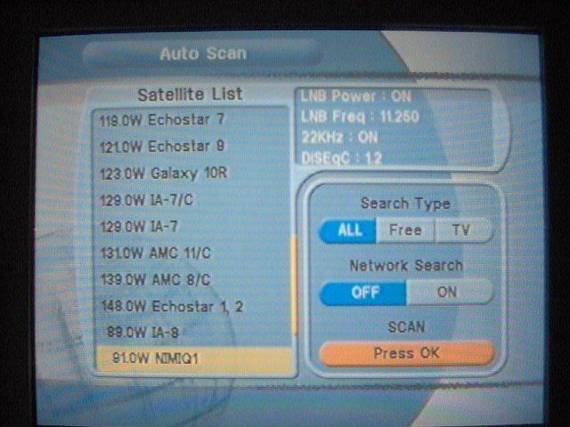

I scanned a few more satellites in so I could see what the unit can do. One option once you are set up is scan multiple satellites. It would scan one satellite, and then move to the next. I did scan in AMC3 so I could check the AC-3 to see if it would output it. I hooked up my simple audio decoder to it and popped on PBS. Much to my happiness, the Dolby digital light came on the audio receiver and I had audio. So AC-3 comes standard on the unit, and I didn’t have to monkey around with settings. The unit has a picture in guide so I can scan my channel list and still see my program. The only thing I have to get use is when you find a channel, you have to hit OK twice. If you hit it once, it goes to that channel, but if you exit out it goes back to the last channel you were on. When you are in the channel guide, it does show the transponder info in the right corner. I flipped over to the audio side, where there is a picture of a radio and your info bar at the bottom, which does disappear after a few seconds. The radio picture is nice, but I would go for a black screen as to prevent burn in on the TV. One thing I noticed was on ExpressVu the EPG populated very quickly. I just wish most programmers would have EPG info. This is a nice feature but pretty much useless since most programmers don’t have EPG info. This does work good for the audio channels because you don’t have to remember what channel has what type of music on it.

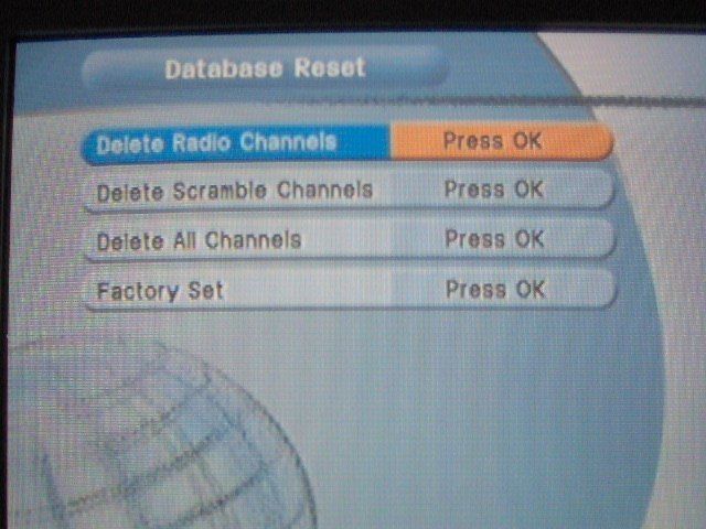

Moving, editing, and deleting channels was a snap. One of the features is you can delete all radio channels, all scrambled channels, or all channels. There are a couple games and a calculator in the setup too.
