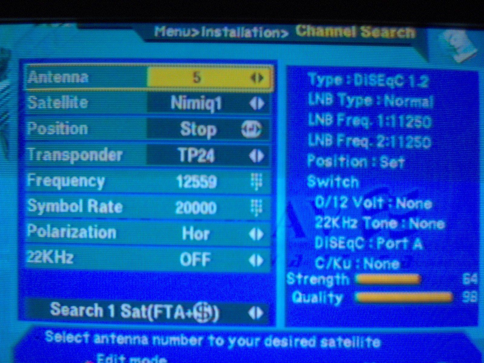

ok did some more searchign and it sounds like it has the same look of a digiwave
If it looks like the below picture, then we're in luck
I think its the red button to allow you to change the info like frequency, polarity, symbol

I managed to find out how to enter the parameters manually and was able to get the Outdoor channels (and others on various satellites). The setup is similar to the screenshot you posted, Iceberg, with a 'TP Edit' option on the screen.
