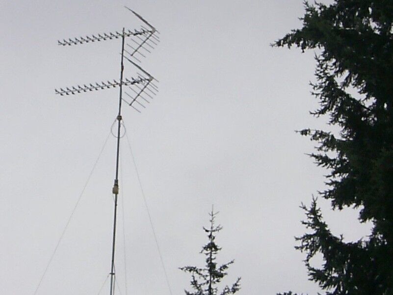

This guy from just outside Portland came up with a dual antenna solution. Check out this picture, then visit the link above for his dilemma and solution. :yes
A RadioShack 2-way, hybrid splitter/combiner ($6.49) should work fine for combining the signals from two antennas.
BTW, regarding the multiple antenna link, based on research posted elsewhere, vertical stacking of identical antennas works best for picking up a weak signal at a great distance. Horizontal stacking works best for picking up signals in a multi-path environment. Also, most antennas trying to pick up hard to receive DTV signals can benefit from some vertical angling of the antennas. 5 to 15 degrees is typical.
