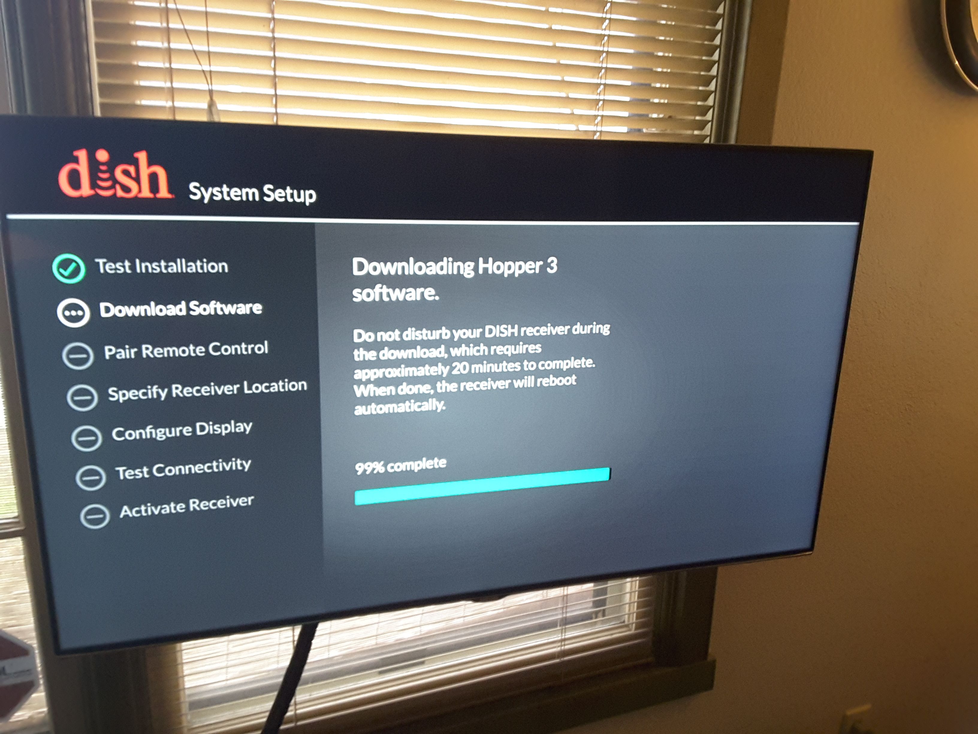

Stardust! You are the man! Our tech got back on the ladder and indeed port 1 one was not hooked up! He said it didn't matter on Hopper One. We are onto the next step.

I guess not, he said it shouldn't matter. Turns out it does with hopper 3! Thanks guys, you literally got us back on track. Our tech today is a nice young (very young) kid from Eugene Oregon. To bad he had to run back back to the shop for another Hopper 3 we didn't need. So far we are 2 hours into this installation.....
