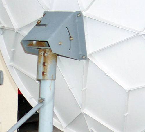

I'm trying to figure out how to put a motor on the dish such as a SG2100. When I look at pictures of that motor I don't see how it would work with the mount on the rear of my dish. Is there a motor that would work with my mount, or can I buy a new mount for the dish somewhere?
In the end the entire setup will be on a pole attached to my deck.
It may work but for an SG2100 I would remove all of the mount as its too heavy (IMO), I recently seen one guys pictures who was using a similar dish and he removed the mount and used angle iron to fabricate two brackets and used two U-bolts or exhaust pipe clamps to attach the dish to the motor, he said it works great, if I find the picture I will post it here, I wonder if Wendys have any more they need removed?
Thanks, I'll see if I can come up with a mount like that. The dish weighs about 18 lbs and the mount on the back 7lbs.

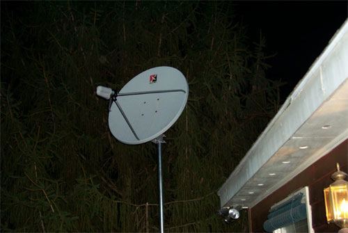

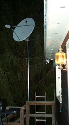

43" Channel Master Dish Installation
I finally got the dish & stab hh120 motor up on the pole.

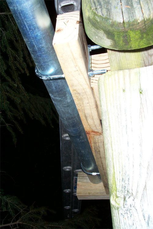

The mount is a custom one from U-bolts, 2x4 pressure treated, and 5" galv. lag bolts. It mounts to the 2nd story of our deck. The mount is stronger than the deck, so I'll have to put some lag bolts in the deck to strengthen it.
The dish isn't aimed south yet or plumbed, but it's not far off.
There isn't any flex in the mount or pole.
Attached are a few photos.

Nice work, its very high! I guess it has to be that high to "see" over the trees? I would maybe add a stabilizer against the building (roof level) to stop any wobble, even a few millimeters of a wobble in the wind can knock out your signal! Its 50mph winds here right now and the signals are hit and miss here, it looks great! :clap :clap :clap
The neighboring lot is wooded, so I have to get as high as I can.
Right now the dish is about 24' off the ground, roughly the same height as the peak of the roof. I am probably going to run some aluminum aircraft cable to the roof peak, and a few other spots. I have a couple hundred feet sitting around needing some use.
I didn't want to see the dish from the front of the house or from the road. Also being mounted here the dish is semi-protected from the wind from two directions.
