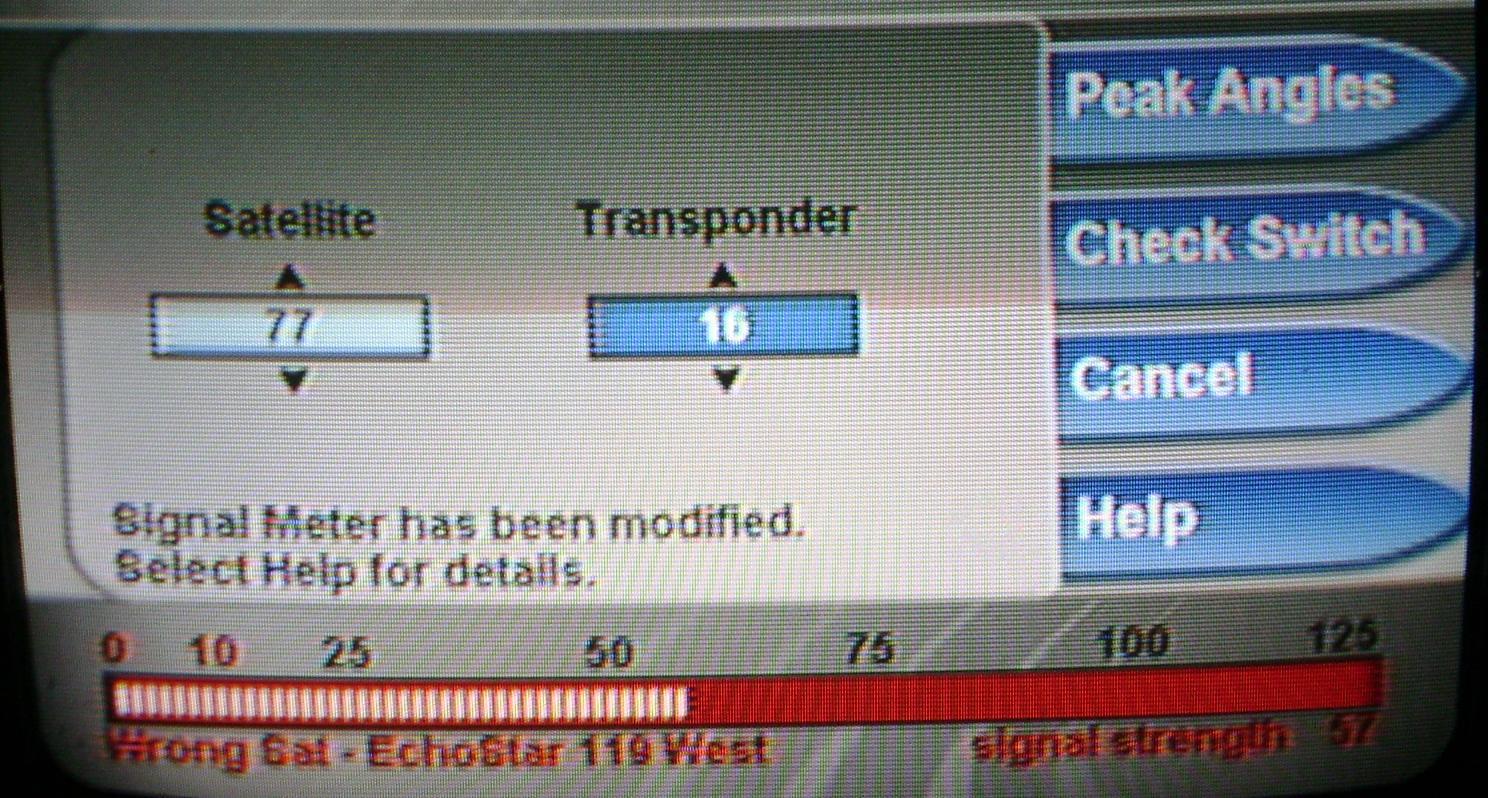

I am looking for some help.... I received a new receiver and dish from dish network to install at a family cabin... I mounted the dish with a clear view and have a signal on the dish pointer screen of 70 but cannot get the signal to lock? I get the program guide to download, but when I go to a channel it shows the program in the guide but no picture (black Screen). Any suggestions or help would be appreciated. The reciever is a VIP211 (I think) and the dish is a 500 with a dual lnb (it has 2 coonetions on the 119 side and one on the 110 side). I installed one coax to the 119 side of the LNB and ran it approx 125 feet to the receiver. But like I said the signal bar goes to 70 but is red and won't lock? :rant:
Underneath the signal meter does it say wrong sat? I found the elevation to be off 20 deg when I setup my dish 500.
When you get back to the cabin, find out what sat your on. Go through the list of satellites till you find the one your on.
Dishpointer and the receiver gave me wrong elevation settings. Try raising the elevation 8 deg and re point.
OK do I go through the list of sats on the dish pointer screen where you put in the transponder, zip code, etc? and will the one i am on say locked or how will i know which one I am on? Thanks
Yes, thats the right screen. Actually it should say what sat you on right next to wrong sat. Go to the sat it says and it should lock, the bar will turn green and it will say locked and the sat your on.

The cable run distance of 125 feet is ok, but be sure you didn't lock on the 119 to the 110 sat..check your elevation cause if its too high it will lock on to the 110 and show up wrong sat. You really shouldn't be any higher than 34..usually 33-32 will hit the 119.
