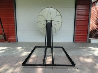

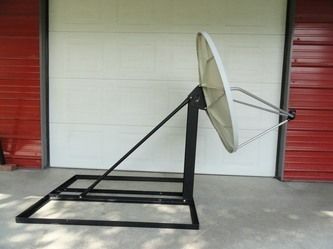

Nice non-penetrating roof mount! The 1 meter CM is a great dish. Many members here have attached them to motors by removing the factory AZ-EL mount and using improvised mounts.

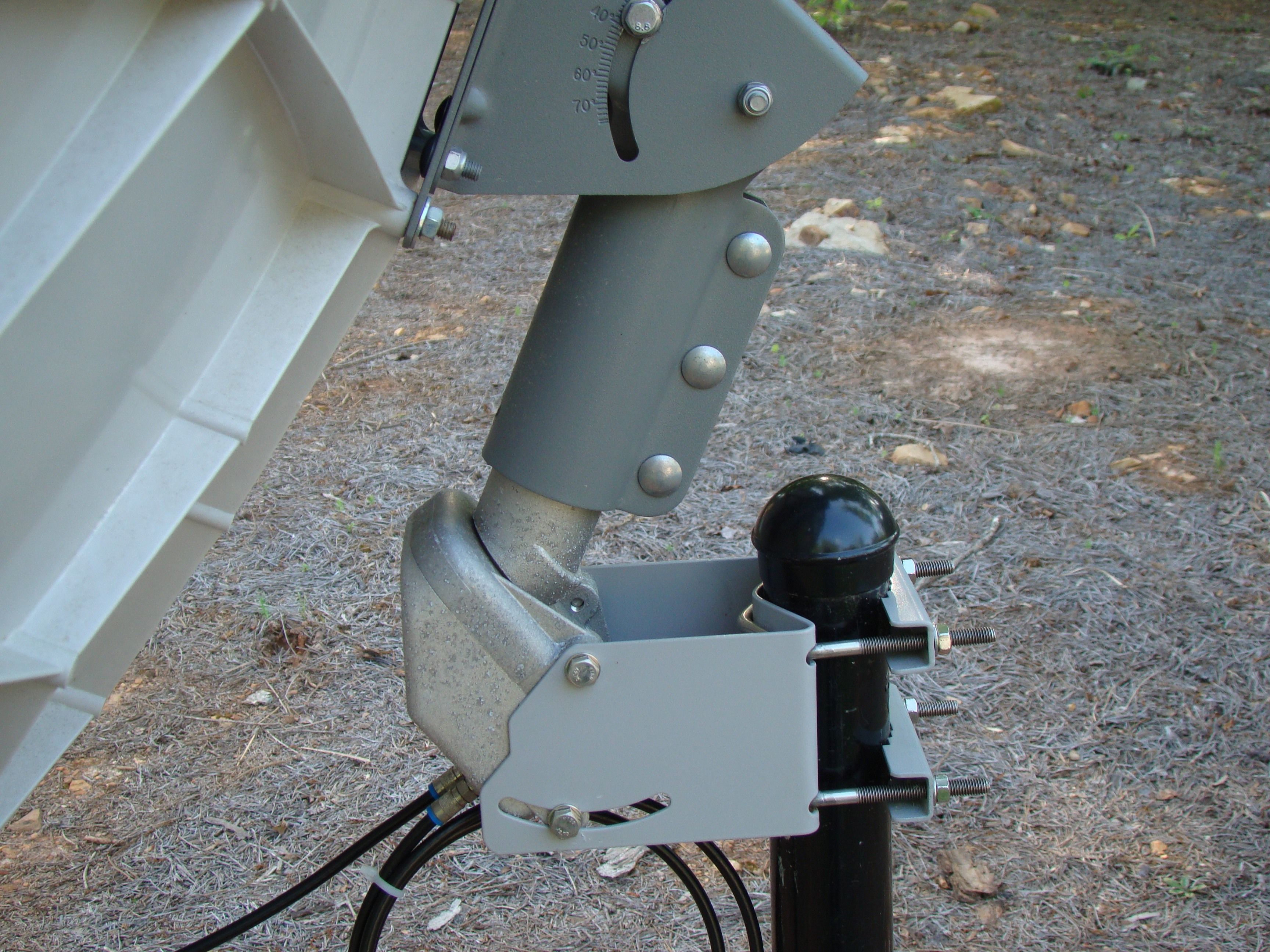

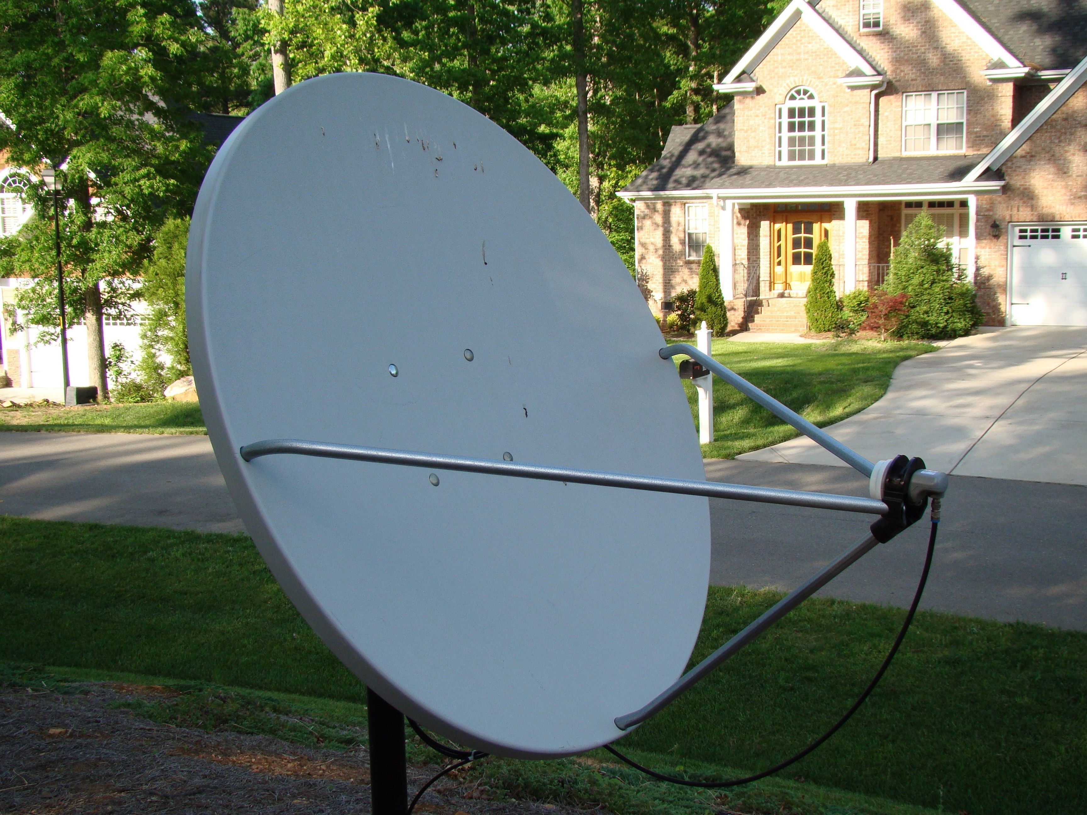

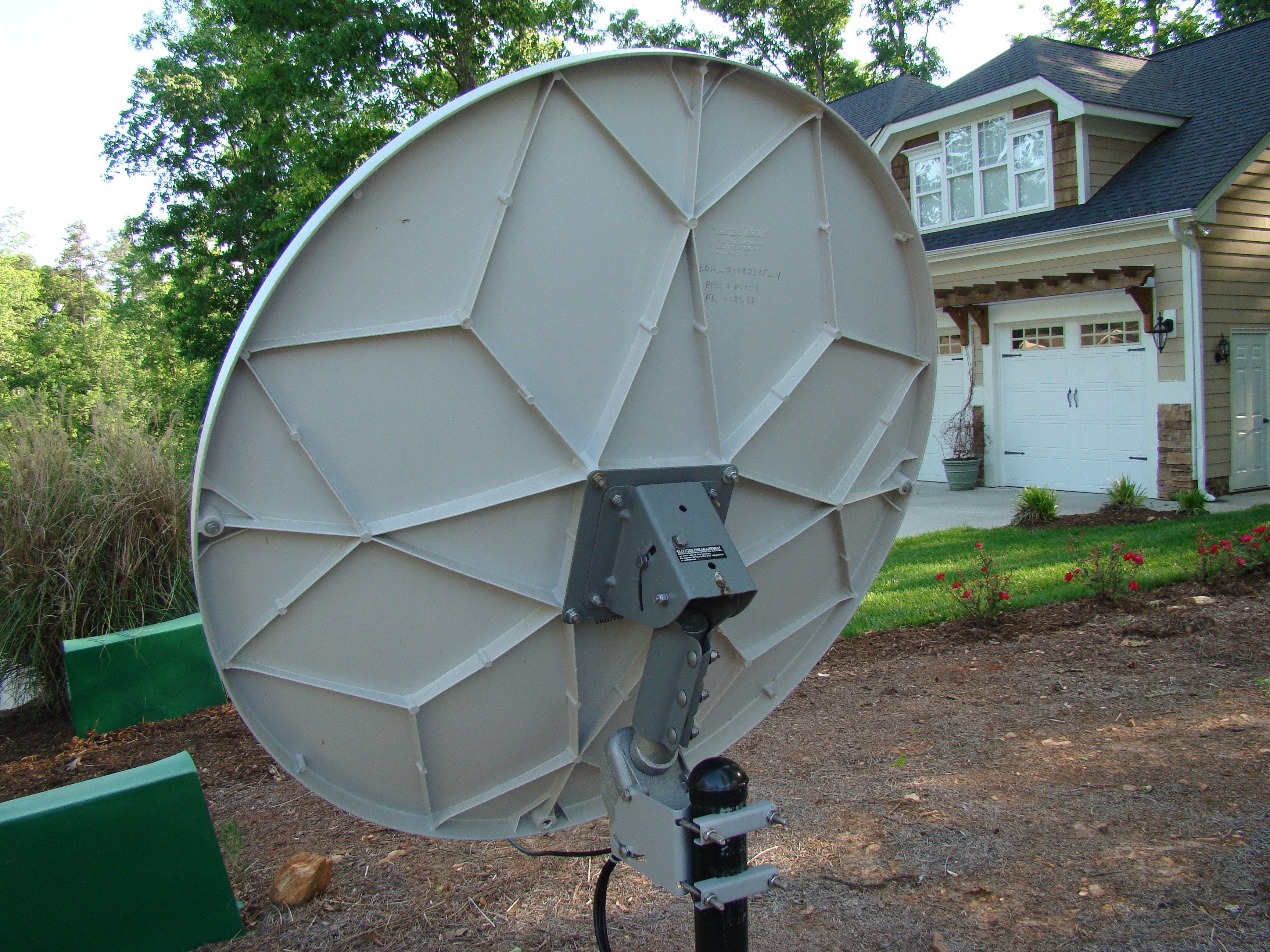

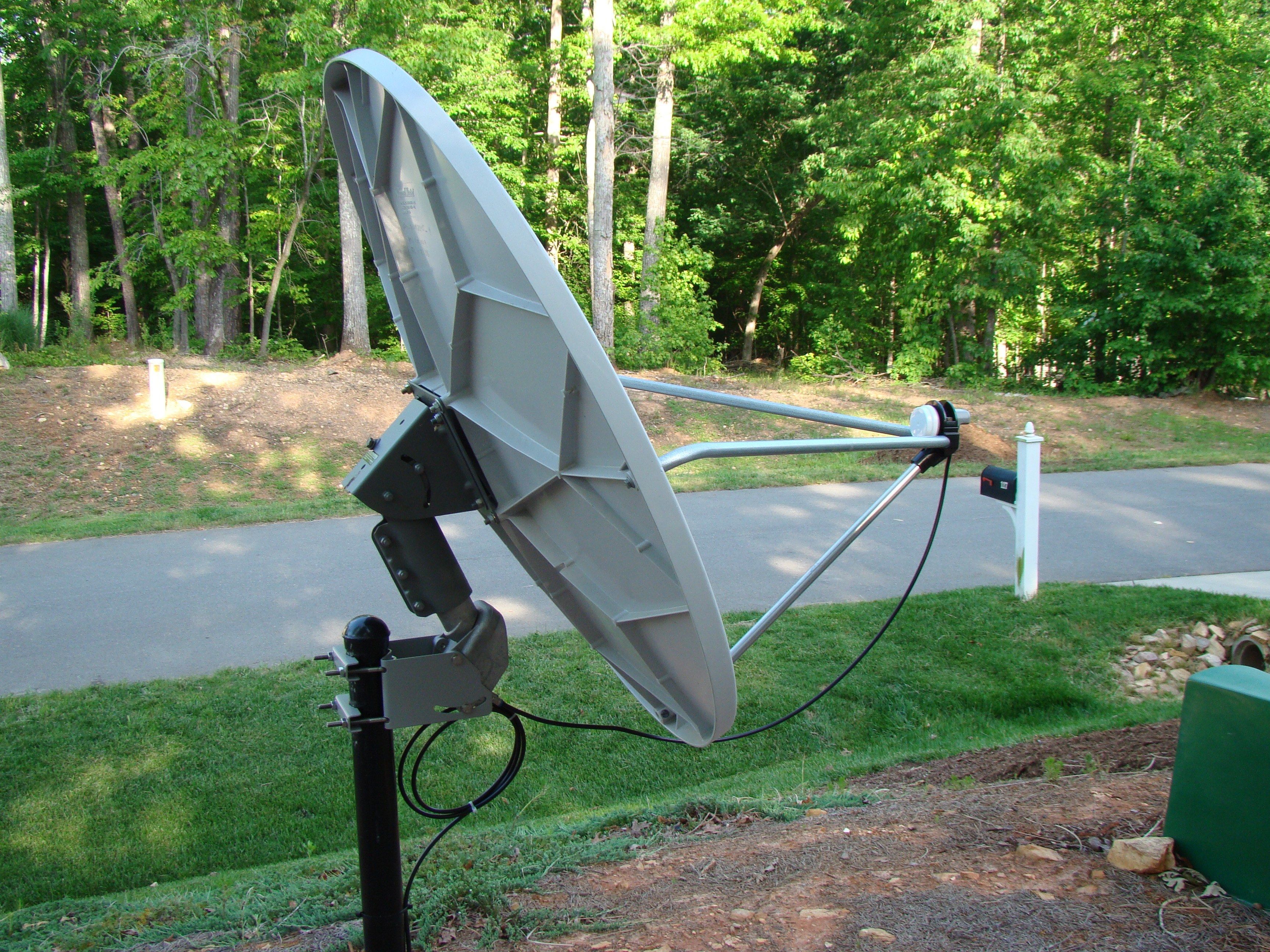

I use a STAB HH120 motor for my Channel Master 1.0 meter......used stock mount w/PVC shim. Works great.
That's how my ASC Signal 1.2 is, except I made myself adjusting steel rings. The dish is 50 lbs & the STAB 120 is rated for 36-38 lbs. I figure my STAB will ware out & then I'll convert it to a polar mount. These commercial dishes are absolutely super.
