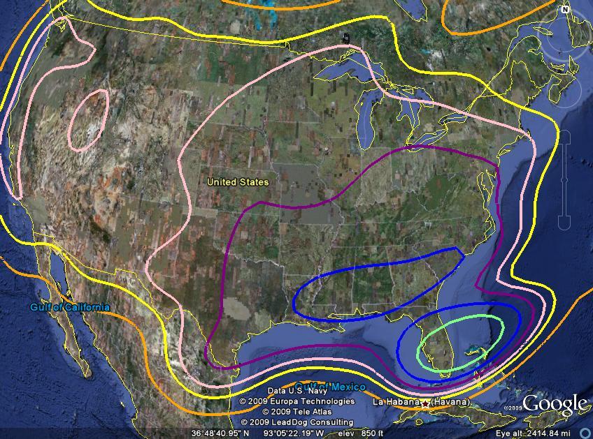

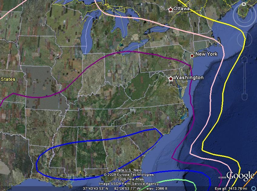

I'd say you have trees in your way. 129 should be easy to find due to the power of it. Only thing that can be confusing on the little analog meters is they don't identify what signal you are locking on. It's easy to tweak on a signal that your receiver can't tune.
In you area though you are in a higher signal strength area for 129 that most parts of the US, so relative 129 CONUS signal strength isn't an issue in you area.
