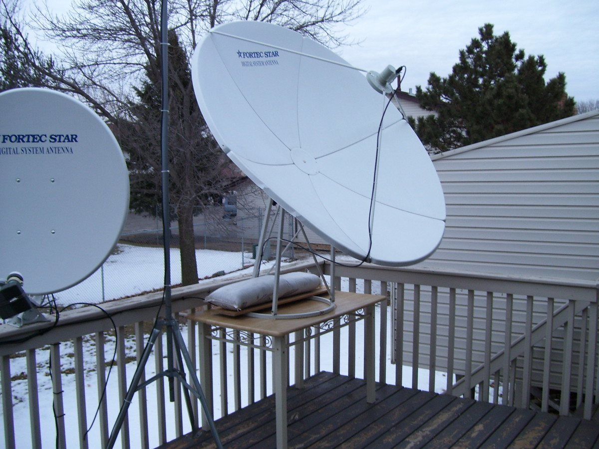

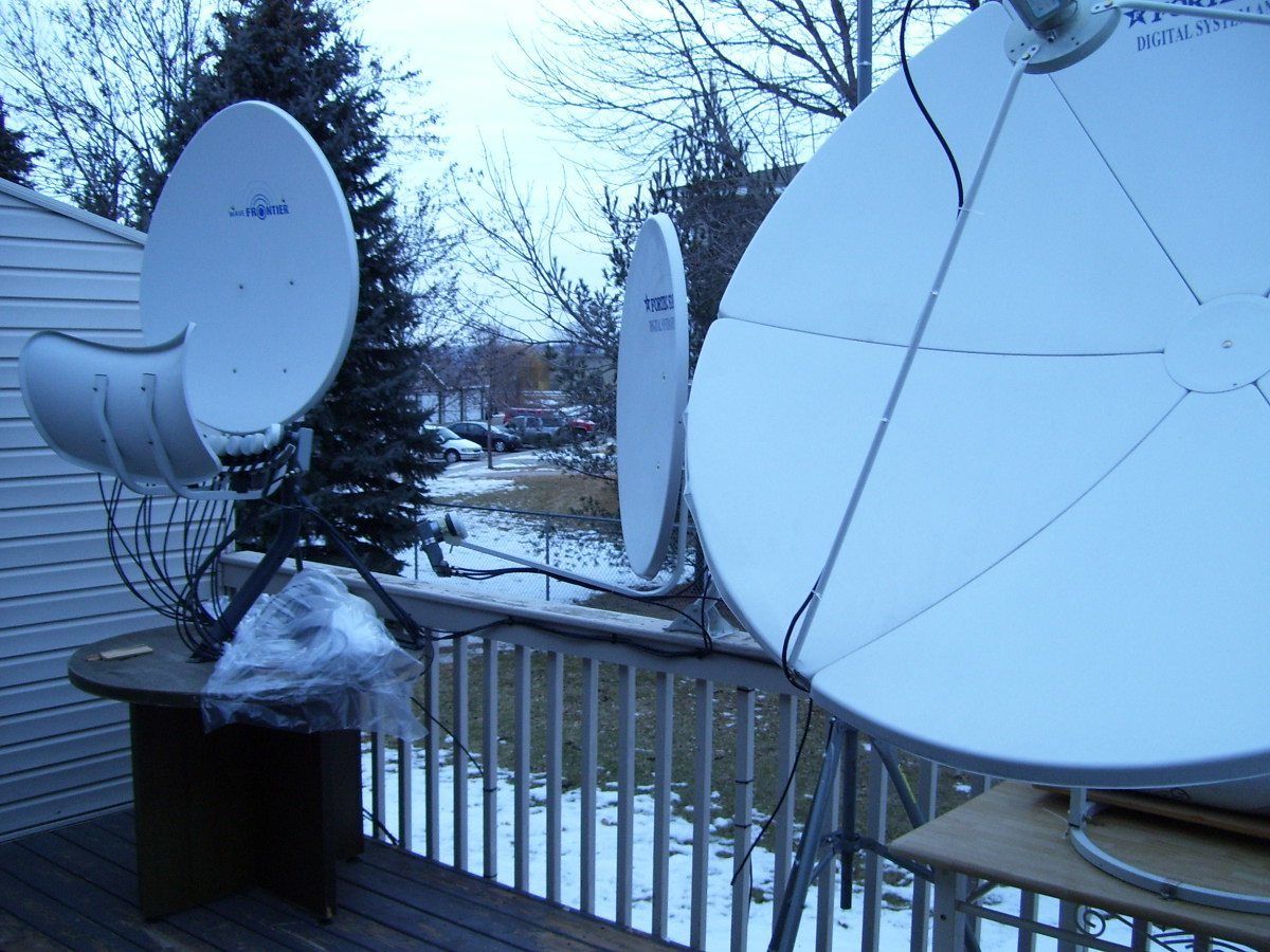

The dish does look at a higher angle than a smaller KU dish which is offset. Here is a few photos of the difference
The C-Band is at 38 degrees (G4)
The 36" KU is at 30 degrees (G10)

Iceberg - Thanks for the pics - helps me out a lot now that I can see the difference in angles. you must have a decent sized deck because the 6' dish doesn't look 6' in those pics.

I like the other dish you have with all of those lnb's. Would a motor have been easier? or do you have more than one receiver hooked up to it?

Not really. The deck is maybe 12 feet out and 20-25 feet long. In the 2nd pic, I was almost in the corner of the deck by the house. The table is to clear the roof line :)
Have a motorized on the roof. This one was mainly (originally) to combine my StarChoice subscription and Dish Net sub together and add a "couple" LNB's for FTA. Now we've got 14 LNB's on it :D I do run 3 FTA boxes, my Dish subscription and a StarChoice subscription via that dish.
