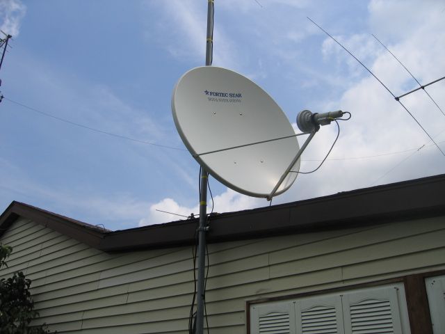

pmb1010, I take you are talking about a 4 footer offset dish. Are you using one of those conical scalar rings with the BSC 621-2 or the stock flat one that comes with it? I recently bought that dual C/KU lnbf but haven't tried it yet on my offset dishes due to the lack of a proper holder and the conical scalar.

Fortec offset, and yes I got one of the last conical rings that seem to be getting very scarce...
Nice setup :)
I hope I can soon get a hold of one of those conical rings, I can't wait to get aboard the mini-bud train!
