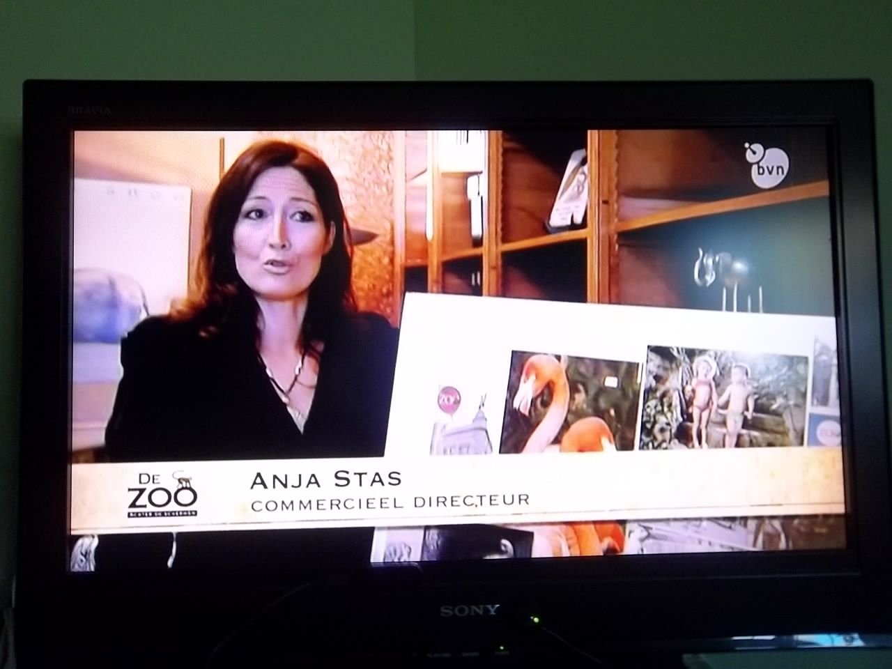

Also, a photo below I took this morning, BVN-TV on Eutelsat 113W. Feel free to contact me.
Mario, N2HUN
