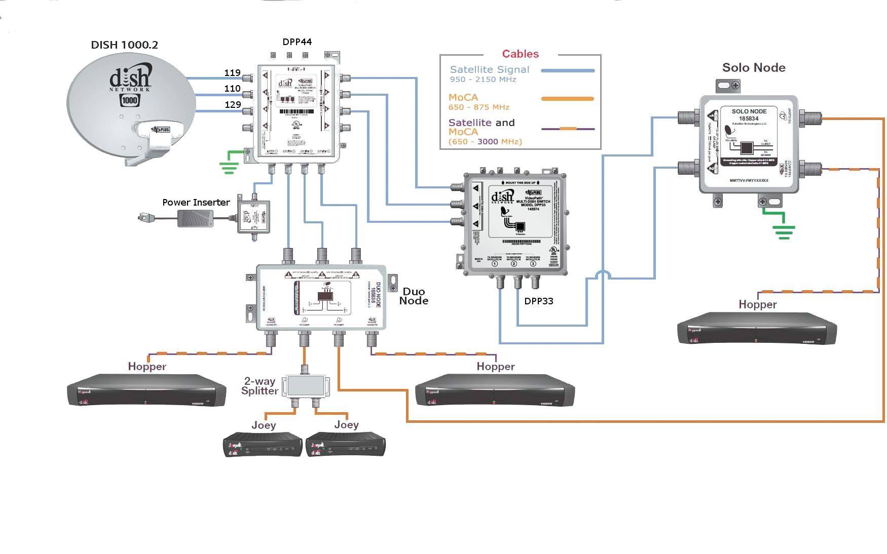

Here's a diagram. Thanks to 3HaloODST.View attachment 79227
Ok, I just want to make sure I am reading the diagram correctly and see if my idea will work. The house will be wired with "homeruns" to each room for standard cable tv. I am planning an having everything run to a "media closet" with in the home with a feed to the outside box for the cable. The idea I had was to run a dedicated pair(I understand that the Hopper requires two feeds from the dish) of cables to a box on the south/southwest(is this correct?) side of the house, were the dish will be installed, back to the media closet where the node would be installed (ground will be accessable from the closet). From the node, the homerun to the outlet for the main TV(i.e the Hopper) can be connected and taps can be used off the client side of the node to connect the homeruns to the rooms where the Joeys will be installed. Will this work? Is there a different way I should look at the wiring. I am hoping to have eveything pre-wired during construction so that the installer doesn't have to drill any additional holes in the walls(other than to mount the dish) or to crawl around in the attic to try and fish the wires required and to hopefully make it easier for the installer. Thanks for your help.
Sounds good. But might you want to plan for three coax into the closet from the dish. This would allow for a duo node and two Hoppers.
Look at the second attachment in post 1 in this link. Especially page 7. Future proof yourself.

Thanks for all the great information. The only other thing I want to ask is, was I correct when I said the runs to the dish need to be on the south/southwest side of the house or is it south/southeast? Thanks again for all the great information. This should make the coax installs better and the dish installation when I move very easy for the installer.
That really depends more on your line of sight issues and cosmetically where you want the dish than anything else. Determine if you're Eastern Arc or Western Arc then go to Dishpointer.com to get a good idea of what your sight line is.
As you would expect, Eastern Arc points more toward the southeast, but the northwest corner of the house may be the best location if it avoids a tall tree.
If line of sight is not an issue, then place the dish where you want cosmetically(back of home) and have easiest access.
