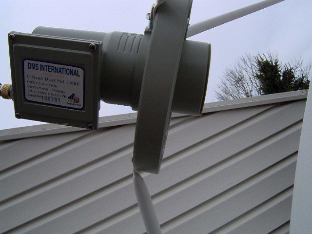

bsc621-2 & Scalar RIng Settings
How do I set the scalar ring? It does not come with a measure mark like the one I have on any other Chaparral? How deep do I get the scalar ring into the feed?
I would just wing it and see if reception changes. On my C-Band only version of that (ASC421) I thought it would be flush with the insde of the rings (the LNB was even with the inside of the rings) but found out for optimum signal, it ended up being in about 3/4" farther in
see attatched
