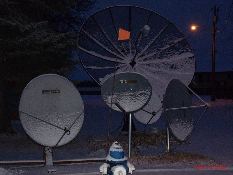

Thanks FaT Air for the good advice. At least it was good up to the part ( before running the lnb coax thru it). Are you running C or C/Ku? What is the reason you ran coax thru the GBox?
I've got C and Ku. receiver to G-Box to Diseqc sw to select C band or any one of 4 Ku dishes, 22khz sw after diseqc lnb 1 to select C or Ku on the movable movable combination. The G-Box is inline so the FTA receiver can tell the G-Box what satellite to go to via diseqc commands. (Eliminates 1 remote. Still have too many on the table)
I like your piggyback dish setup. What size is that offset you bolted to your big dish? It tracks good across the arc? I like your use of the 22KHz switch. I am in NE Alberta Canada and am getting PBS on 125 AMC 21 75Q on a 42 x 39" Winegard. I am thinking of trying your invention out with an old 32 x 30 offset that I can get 70Q with on AMC 21. Do you figure the piggyback is not too much extra weight on the old C-Band dish.
