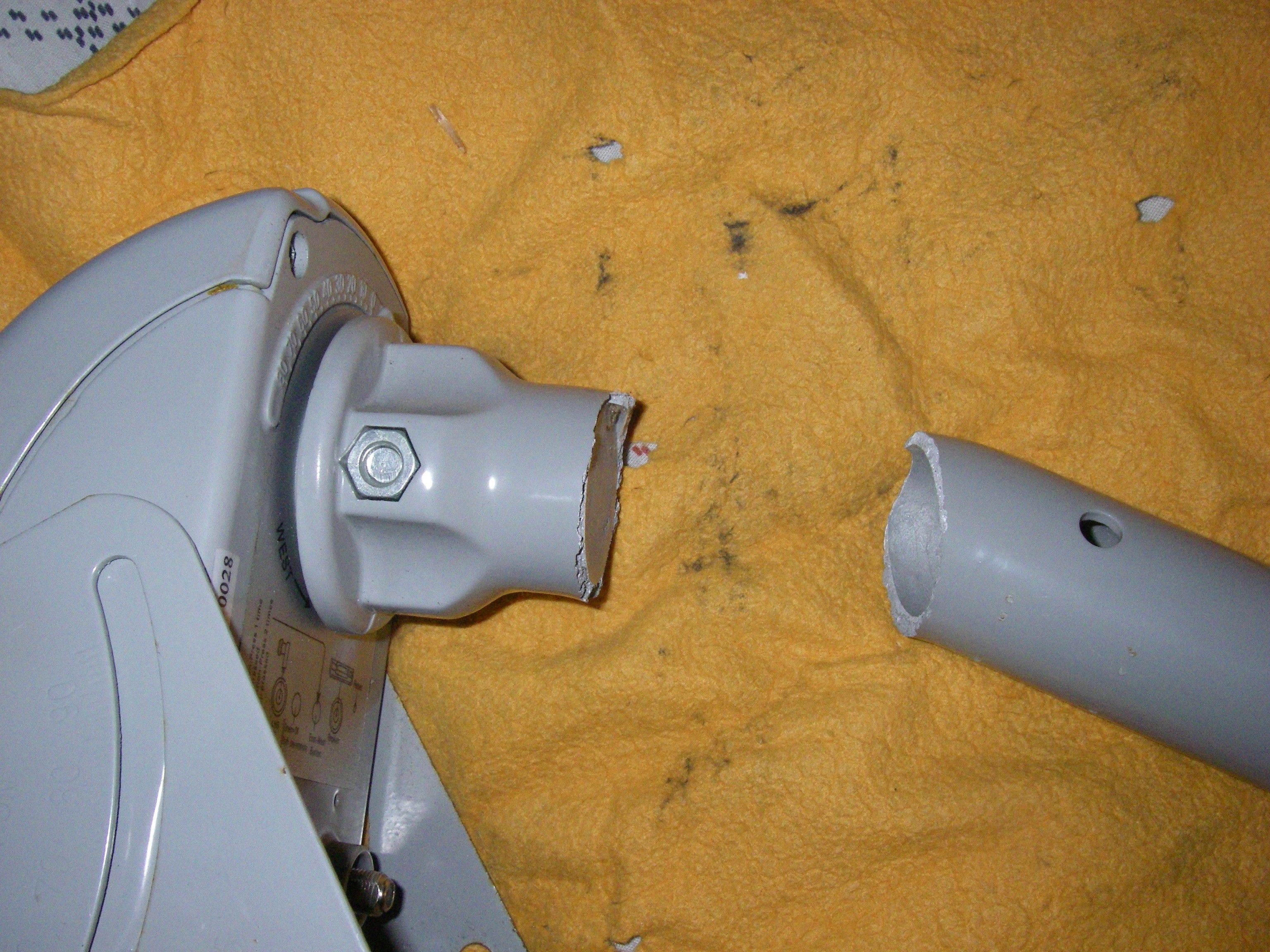

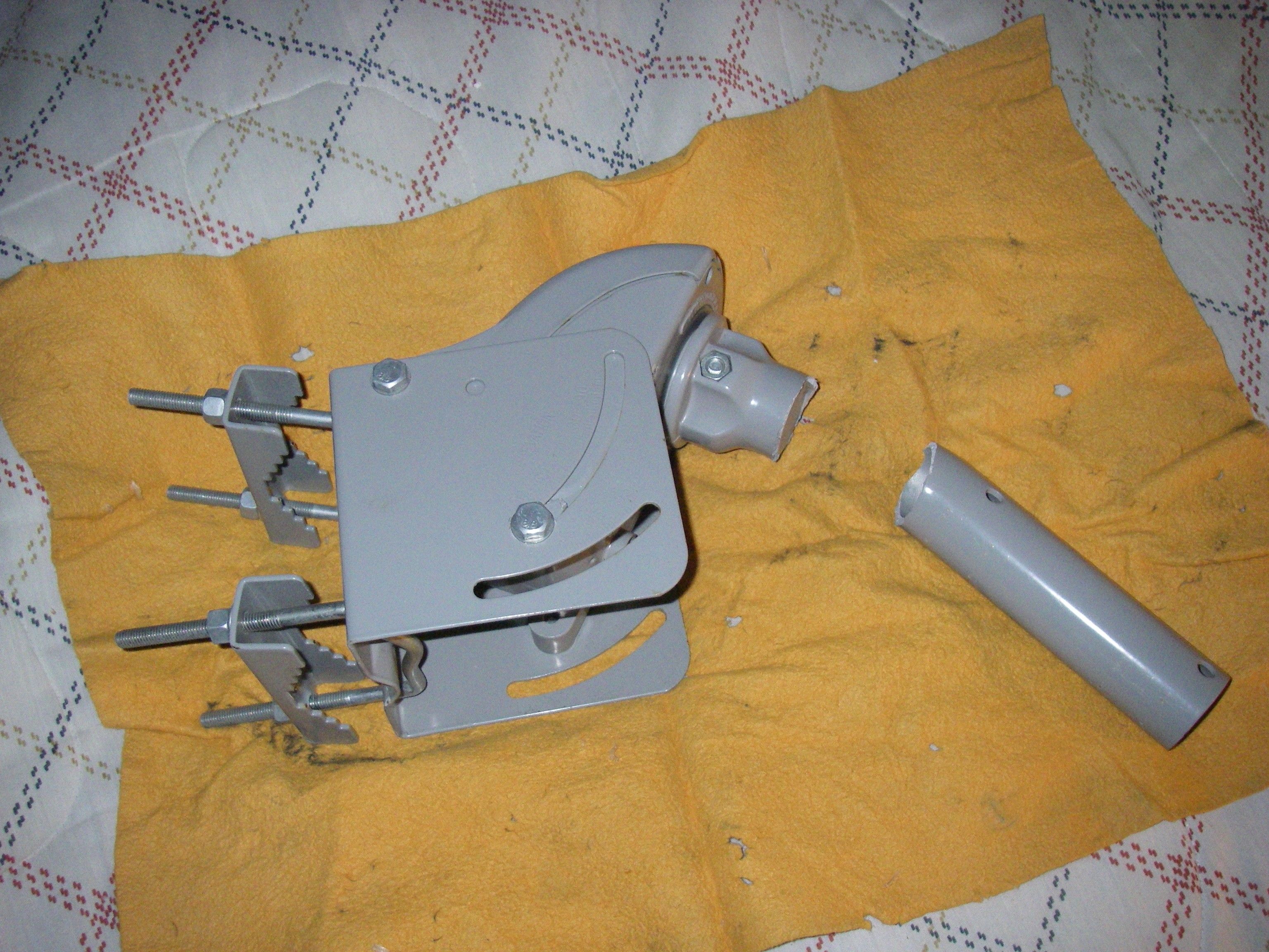

I was adjusting the dish elevation about a week ago in the usual manner, loosened the 6 bolts that hold that adjustment so that the dish could move but would stay in place when I let go. I must have had them too tight because the shaft broke in two while I was moving the dish. This shaft is made of cast aluminum it appears and it broke right where the hollow part of the shaft begins. I've attached a couple of pictures here -
WSI sent me a new shaft for about $30 with the shipping - be careful with these things - they're more fragile than they appear.
