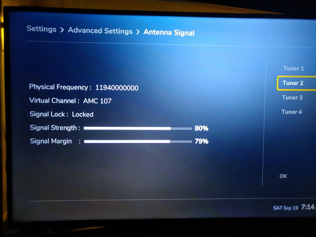

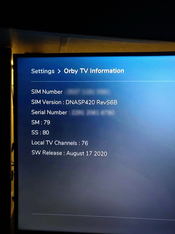

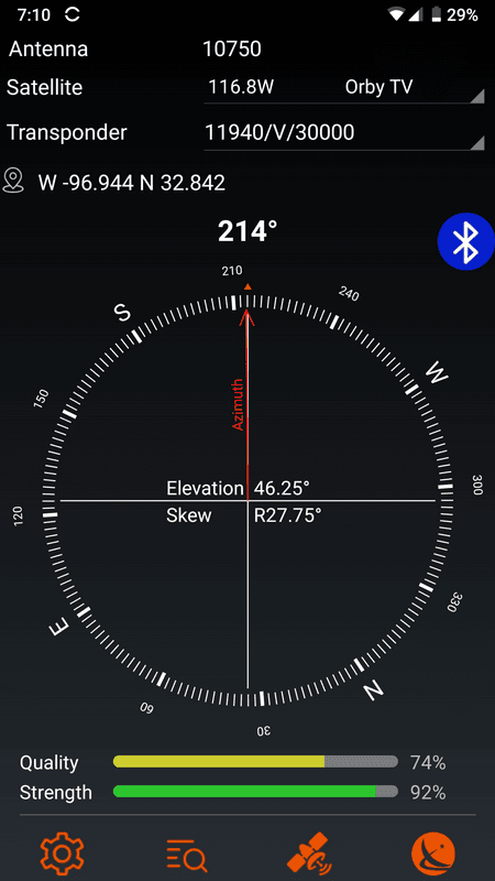

I'm in Dallas, Texas, with a wide open view of the sky. Best signal quality I can get with the V8 Finder meter that came with the self-install kit is 74%. Does that sound right?
Don't have the BT meter but your signal on the tv is higher than I have here in central FL using a converted slimline. I got SS 83 SM 75. If a heavy cloud rolls over even with 100 signal will be lost. That's linear KU band for you. At least if locals are available can watch those until heavy cloud clears.
Looks like you have a solid lock. From what I have seen is the picture will drop right at the 50% margin so you have plenty to spare.

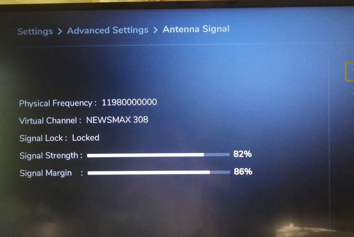

Below is the best I could get and I'm in Central Florida.
