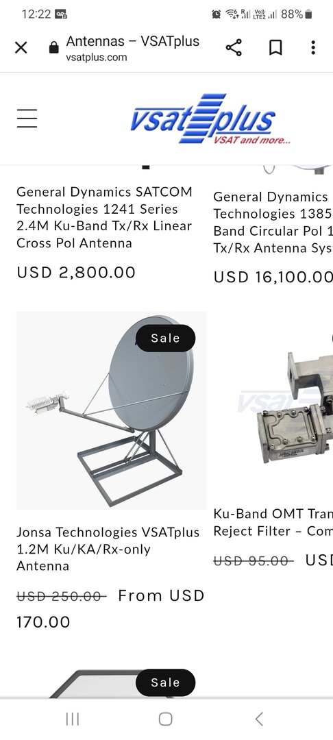

Receive only and a great price. California office. $170 on sale

Will that mount on back function with an HH motor?
I'm not sure what mount it has but it would almost certainly require some fabrication to breed it to a STAB-type H/H motor.
If that is a stamped steel dish I believe a STAB 120 would handle it, if you can find one anymore.
A fiberglass 1.2 meter will require adapting to a polar mount or an AJAK or Birdview H/H mount to handle the load.
I have a 1.8m fiberglass offset that I hung on an AJAK and it handled that heavy dish with ease.
Can't say to a certainty based on the photo, but that looks like a standard cinder block NPRM mount. If so, the dish just slides off. Put it on a pole-mount or an NPRM with a larger mast, like this one- it's what I used.

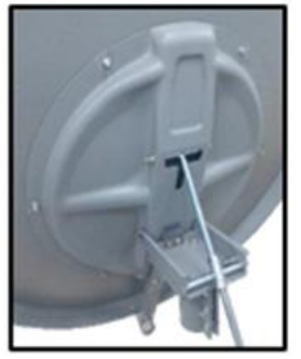

A picture of the rear mount is shown in the product manual available for download on the vsat site. I enjoy a good DIY project but this doesn't look particularly HH motor friendly.
