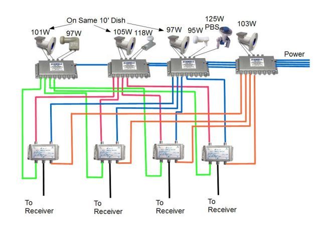

I have a hookup in the den. When you hookup a known good receiver in there its fine, then after an hour no signal on any sat. Mutiswitches are fine, no problem on any other receiver in the house. Figured it had to be the Amiko 4x1 diseqc on the drop to the den. Trying to get all the last minute tweaks done while its in the mid 70's here.
Will swap out tomorrow.
All four Diseqcs will be Chietas then:
Diseqc switch swap fixed the issue.
I was running two Amikos and two Chietas. The receivers connected to the two Chietas remain on 24/7.
The receivers connected to the Amiko switches only on sometimes.
I always pull power on receivers and multiswitches when working on system.
No idea what caused the switch to go out.
