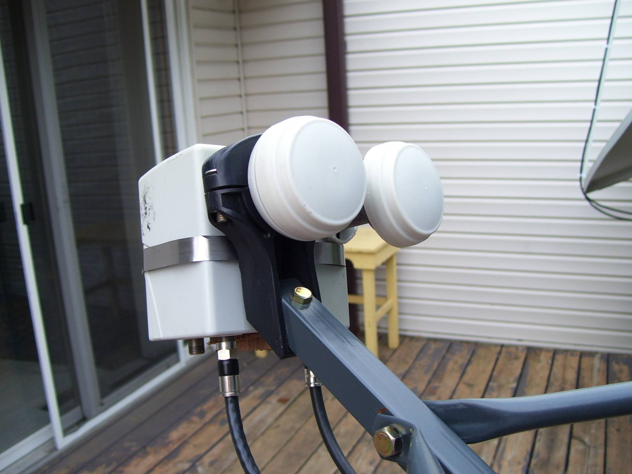

actually looking at that you might need a 48".....it can be done but requires ghetto rigging since larger dishes only see one satellite. You have to rig it to see two.
You could use 2 dishes....the stock dish on 91W and the larger one for 82W

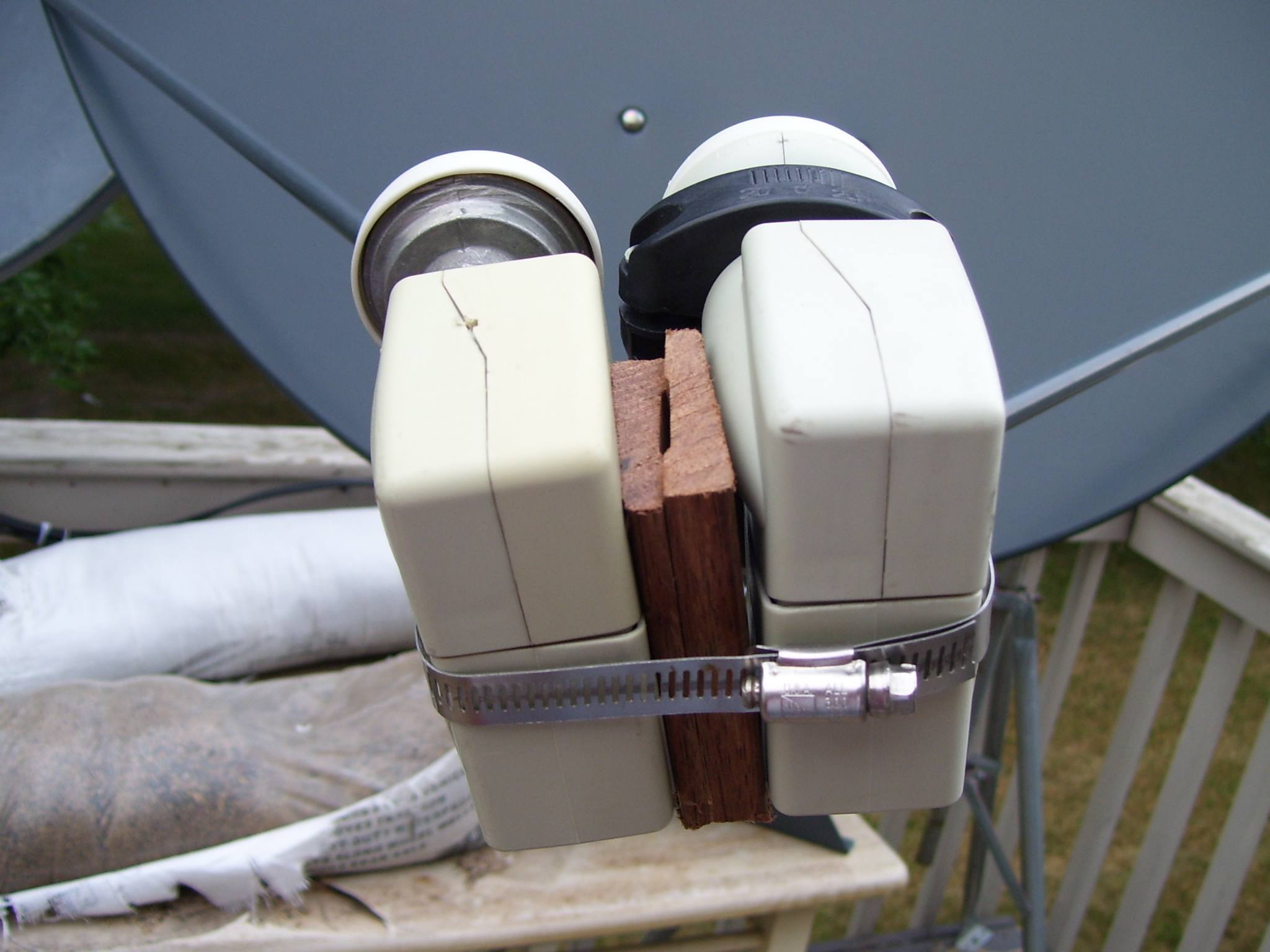

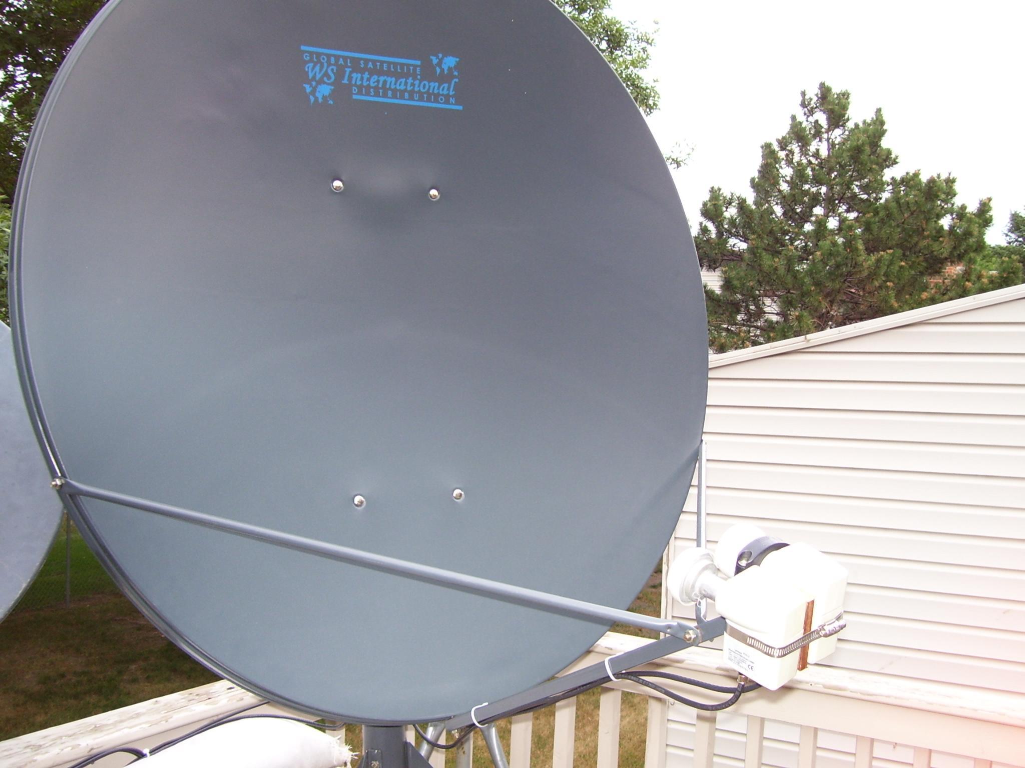

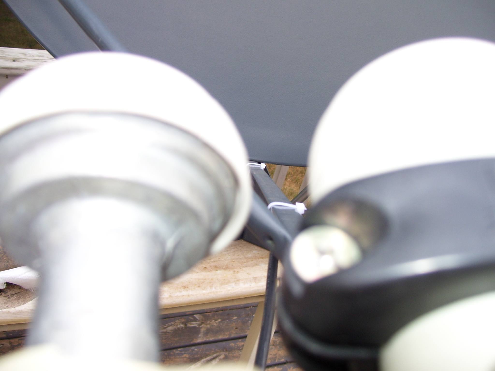

Here is my "ghetto rig" for Shaw Direct (the other Canadian DTH provider) on a 4 footer

Fortec would work but that would be for one satellite only unless you rig something up

So basically what your telling me is as long as the dish size is the right size, the brand of the dish really doesn't matter. Because I noticed you have WS International for your dish. So any brand of dish will work for Nimiq 1, just have to worry about the size?
yep. Do all my rigging of my dishes
no coverage is perfect but I live in Minnesota and it worked great. Really strong signals and very little rain fade issues
