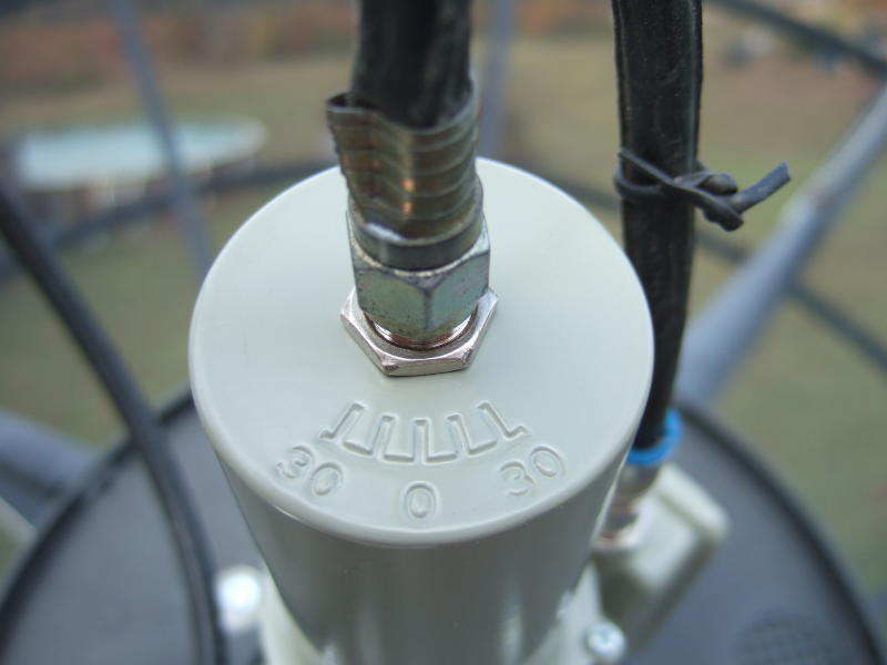

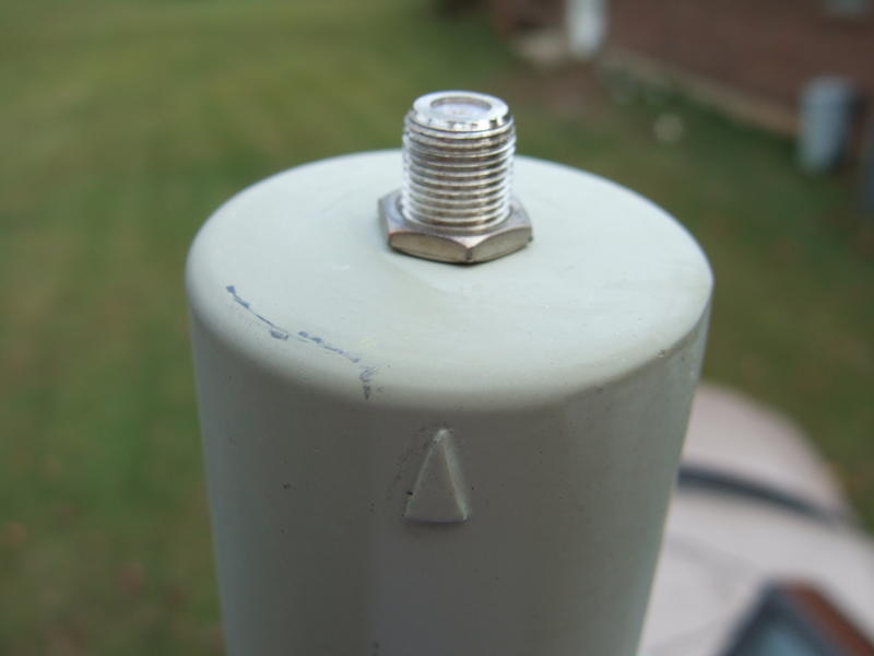

we were adjusting the feedhorns I have a bsc621 ( actually i have two)
i first took readings with my Coolsat 5000 and then used my Traxis 3500
my polarity mark was pointing to 12:00 ( but was at 6:00)
i did adjust it to 8:00 and lost signal and moved it to 7:00 then to 4:00 then to 5:30 and reset it back to the original 6:00 . Now the main problem i actually think i'm having is the feedhorn has a lot of room to move in the scaler and it hard to get it level or straight in the scaler and the metal feedhorn is very easy to indent with the lockdown bolt.

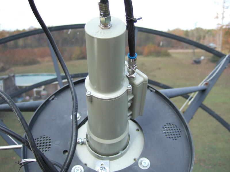

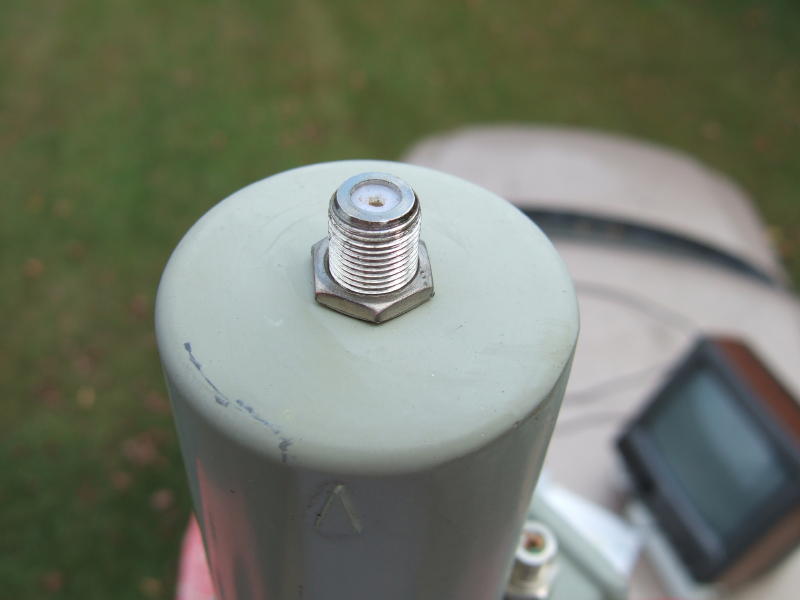

i still need a better method to check to see if its correctly seated into the scaler ( i suspect it wouldn't take a whole lot to be off and every little bit is throwing me off. i will try again to gain some center area of the arc I did lose ground in the center of my arc spirit TV on 87W was at 87 on the coolsat and now is at 70
included are pics of the old bsc621 with adjustment arrow and newer bsc621 with a number scale
