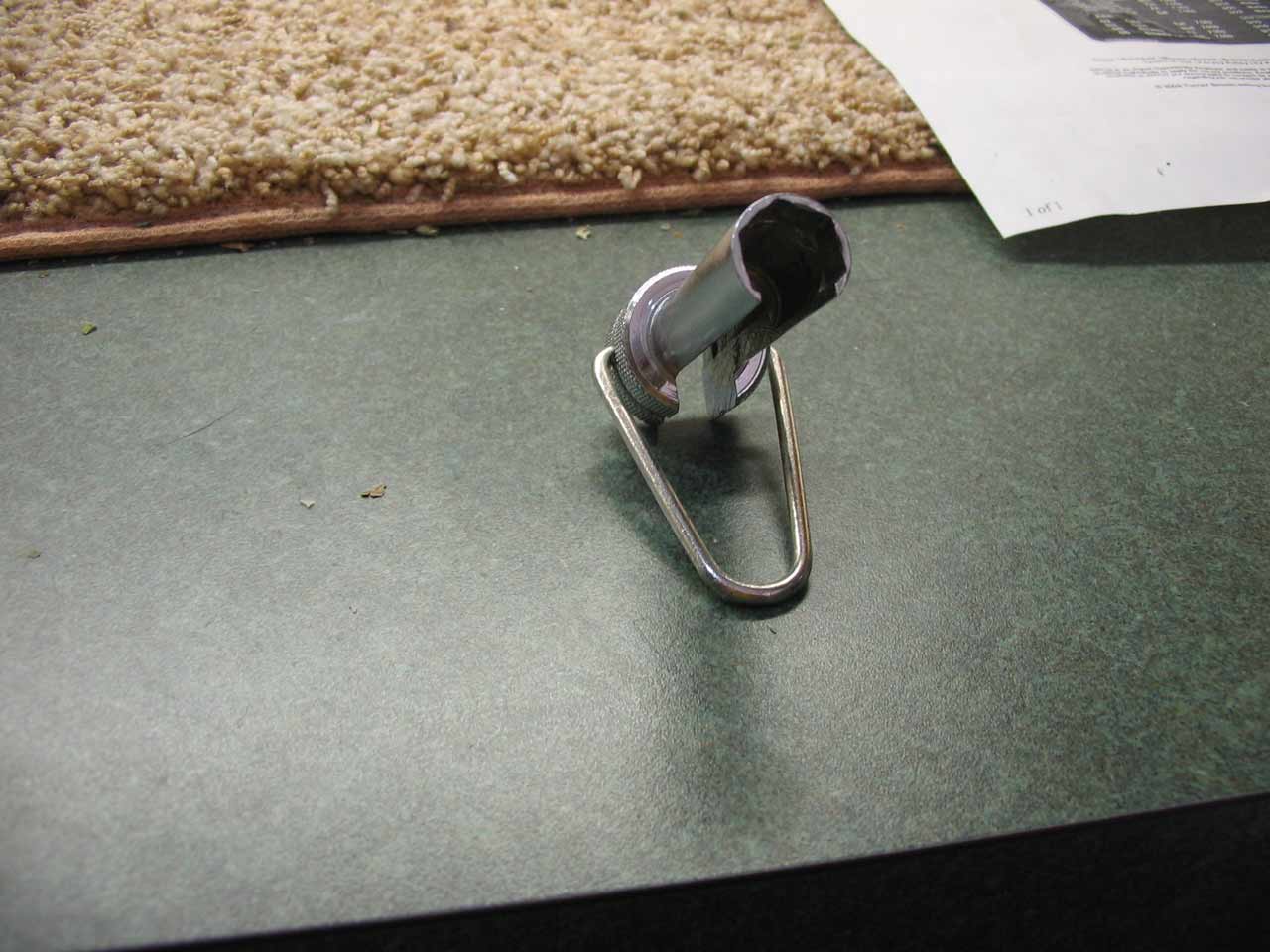

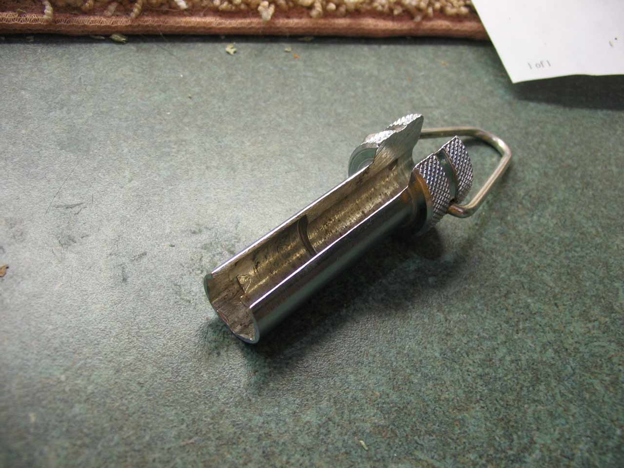

I had the identical issue only about 3 weeks ago with my SG2100. It seems the barrel connector just threads into the cheesy bracket and pulls out without much help. I threaded my connector back in, then put a NUT inside the case , as well as outside the case, and tightened the outside nut down. The inside nut becomes a strain relief, so hopefully it doesn't happen again. Here's the tool I used, it's a "security" wrench for cable system.

Thanks. I ground down a cheap socket to fit inside the hole, but it wasn't deep enough to clear the barrel connector. I tried to drill out the socket on my drill press, but the darn socket was too hard for my drill to cut. So I put a couple washers underneath the nut. It's on there very securely now, and I don't think that you need a nut inside, because the outside nut will pull the inside up against the case. Unfortunately, I seem to not be making contact, so I think I'm going to have to take off the other side to be able to work on the connector, and get it to make contact before putting them in the holes. But I'm going to play with it a bit first before going that route. The motor does seem to be able to turn though, as I powered it up, and it moves east and west via the buttons, but it's the LNB connector that I messed up, and no power seems to be coming out of that.
