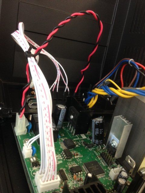

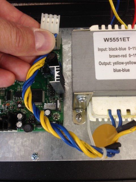

Back to checking the wires inside of the ASC1, When you reassembled, make sure that the Servo and Sensor ribbon wires running from the main PCB to the f-connector PCB are routed up near the top of the case and not laying near the transformer, AC wires or down on top of the main PCB. You might also cut the nylon tie and separate the Red/Black (M1/M2) wires. Twist the Red/Black wires 10+ times and plug back into the main PCB. Also twist the transformer Yellow/Blue wires 5-7 times and reconnect to the main PCB. These wire bundle twists help control noise internally.

I took the ASC-1 apart again and moved the wires away from that big transformer. Twisted the transformer wires several times. Also added the .01 cap on the motor wires. Think I will also take a look at the inside condition of the motor on the actuator. Again, when daylight returns. I had a choke or two around here somewhere. Would have been smart if I would have put them in the electronics junk box when I pulled them out of ???? I think it was a laser printer.....

Edit: Thought I should add that it did move after the wire move in the ASC-1 in post #27.
