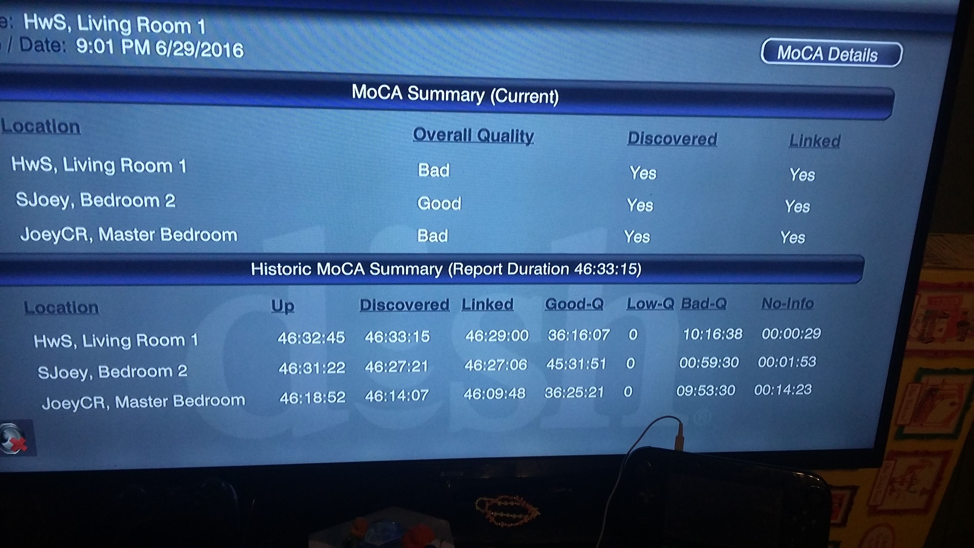

Sounds like the most of you think its the node... not sure if this can help identify it or not.. took this picture a few minutes ago.
Also, this started happening around the time of the last update for my joey, is there a possibility that could be it?

Just get another node. If it is an older model node , they can be heat sensitive and fail in high , hot temperatures. I had this happen with my first gen hopper when I had it back in 2012 or 2013. The newer nodes are built to be more heat resistant.
No it-doesn't . I have no Taps at all. But now that I have the hopper 3 I use the hybrid switch instead of a node. Much simpler setup.
