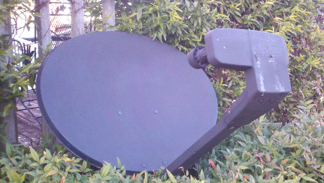

My Mobile, Al install was on (110/119/129) and its the black one. In reading I see they had a 1000.2 and a 1000.4, then they phased one out. If I read correctly the 1000.4 is slightly larger, and now just takes one of two LNB's depending on the arc.
Just wanted to make sure I knew what was just installed.
Im pretty sure this is an example of what I have:

Where the end of the arm attaches to the bottom of my dish is stamped, and just in reading it seems that is a 1000.2.
1000.2 are still used, depends on your area and what arc your pointed at. All my installs out of our office are .2 which are black reflectors.
Yep. We don't use the .4's any more unless it's necessary for a Latino package customer. That's the only programming on the 77 orbital with the exception of (I think) locals in some markets.
We use the .2 for EA and WA installations.
If you're curious what you have up there hit menu, settings, diagnostics, system status. Next to "Device" it'll say 1k2, 1k4, etc. Technically that just tells you the lnb you have up, and a .2 WA lnb WILL fit on a .4 reflector in a pinch.
