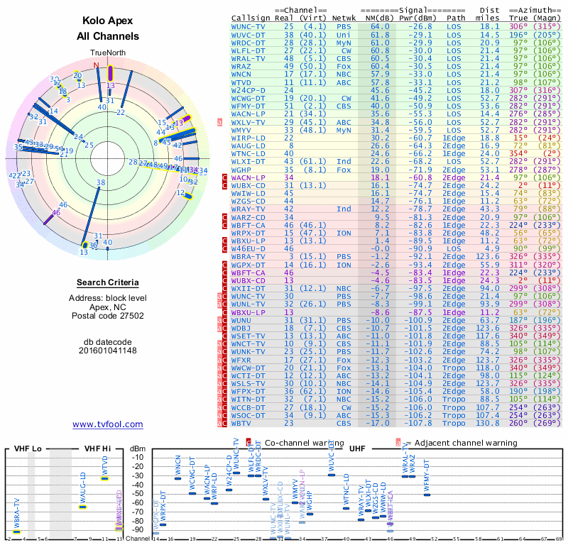

How far are you from the PBS transmitter?
18.1 miles according to tcfool. See attachment --- the PBS station is first on the list, WUNC.
