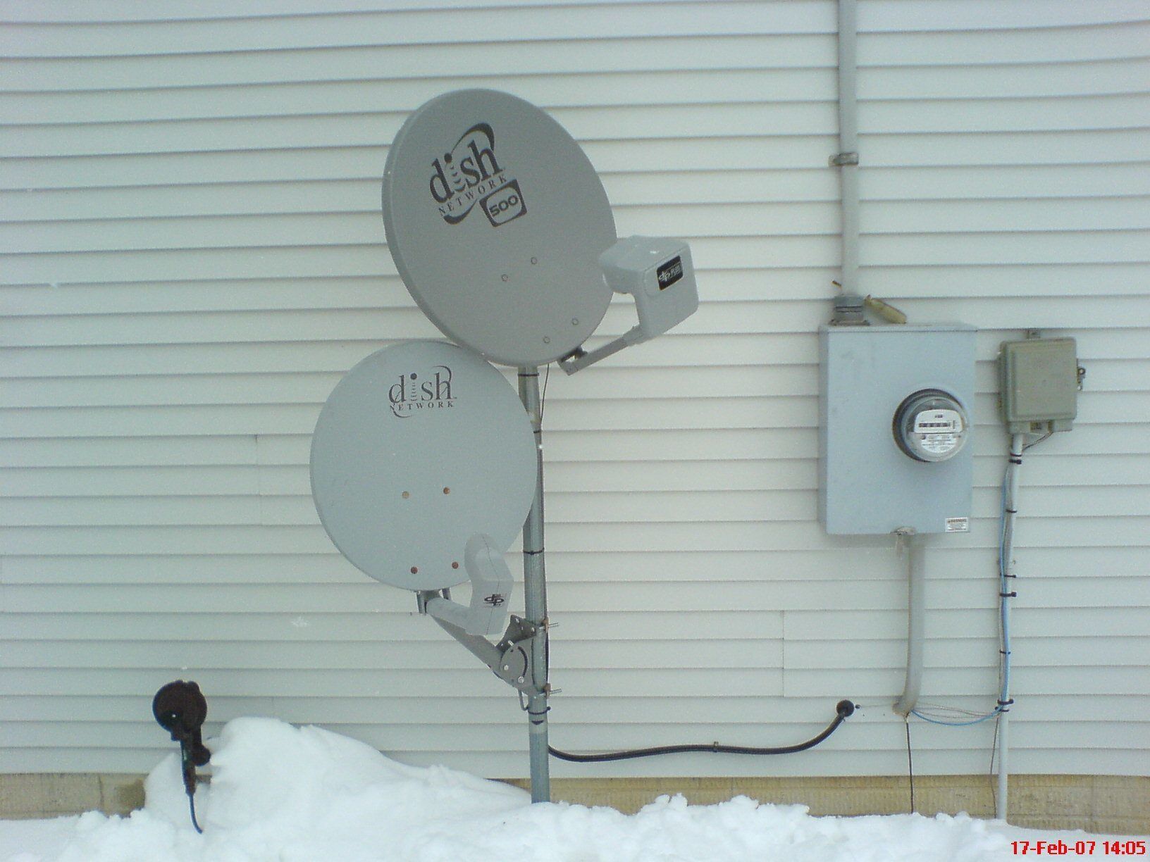

Here's a pic of my dish tree. :D
Now I believe you swapped the legacy with a DP.:D LoL
If the 300 has LOS that close to the ground, then the only thing left I can possibly think of would be the 500 LNBF cluster blockiing the signal to the Dish 300; if during the original attempts the 500 was a little more westward, and the 300 was more eastward. But not in the current mounting positions.
Nice install, I did that once when I was out in VA. But I used a 35' TV mast, stuck it in the ground a couple of inches, then used a bracket to attach it to the side of the 2nd floor deck, with the mast only extended right above the deck railing. I used a Dish 500 and a Dish 300. For 61.5, due south, it did not matter if the 300 was on top or bottom, but the 500 for 119 & 110 had to be on top to get LOS.
