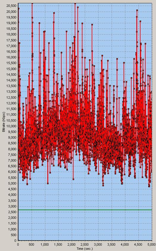

Measured peak bitrates of movies on 9423 ( HDNMV ) 1440x1080 at 29.97fps at end of January:
Broken English - 17690 Kbps
Dating the Enemy - 20925 Kbps
Kramer vs. Kramer - 20721 Kbps (see a graph)

Those are the peaks. The average is closer to 9-10Mbps. Even people without the ability to capture and analyze the stream can estimate the bitrate by just looking at the file sizes on their DVR.
4 mpeg2 feeds on one TP (with ~38meg available for video) = sucky. Until these move to mpeg4 dont expect too much from them.
