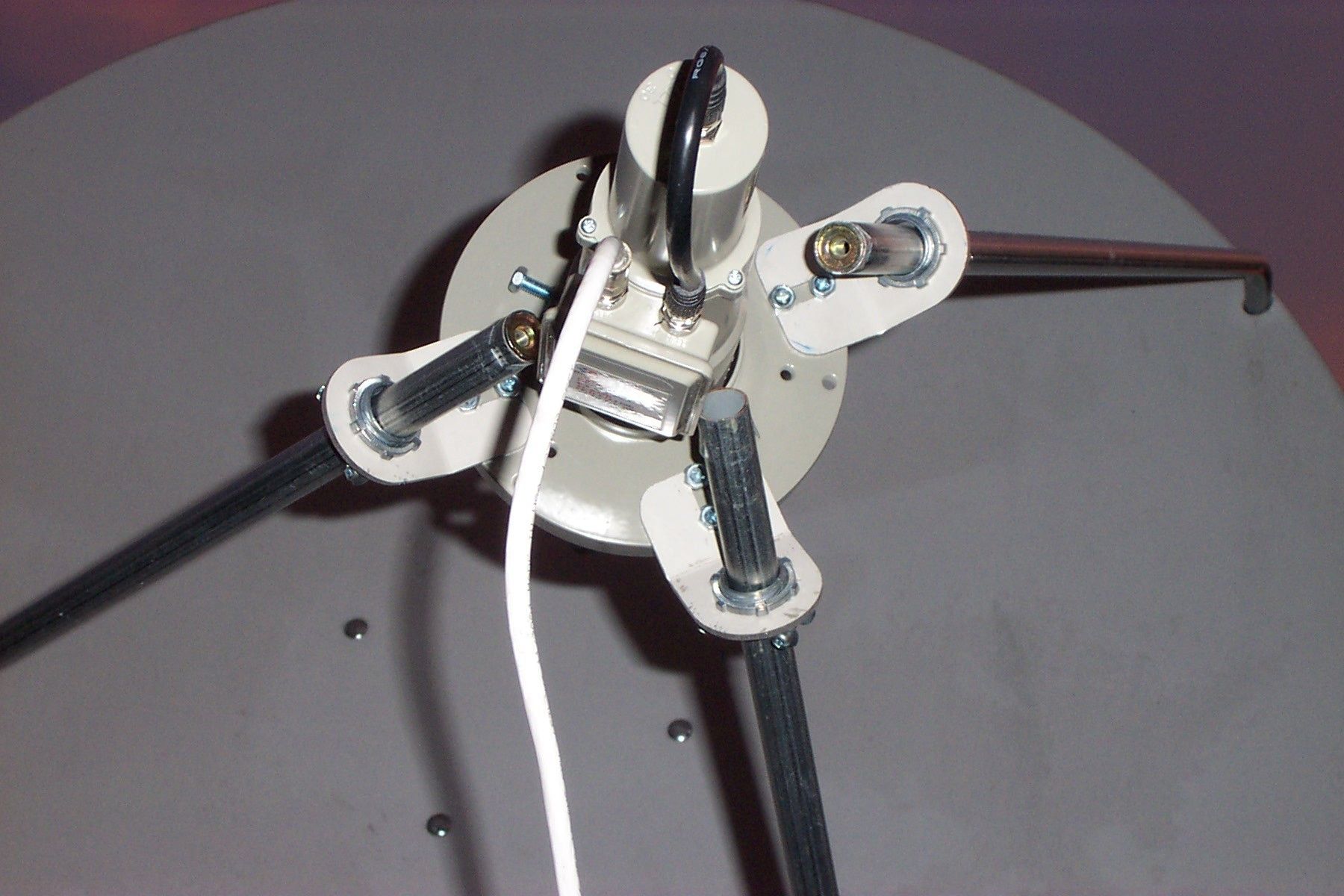

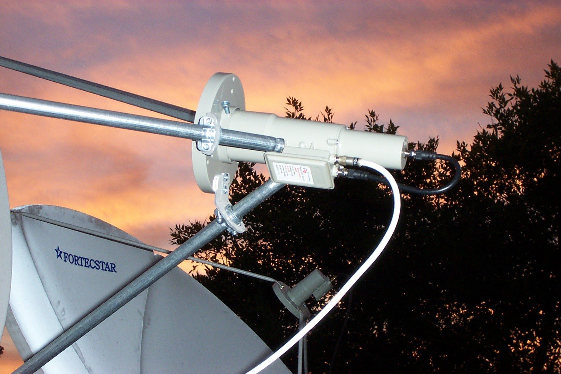

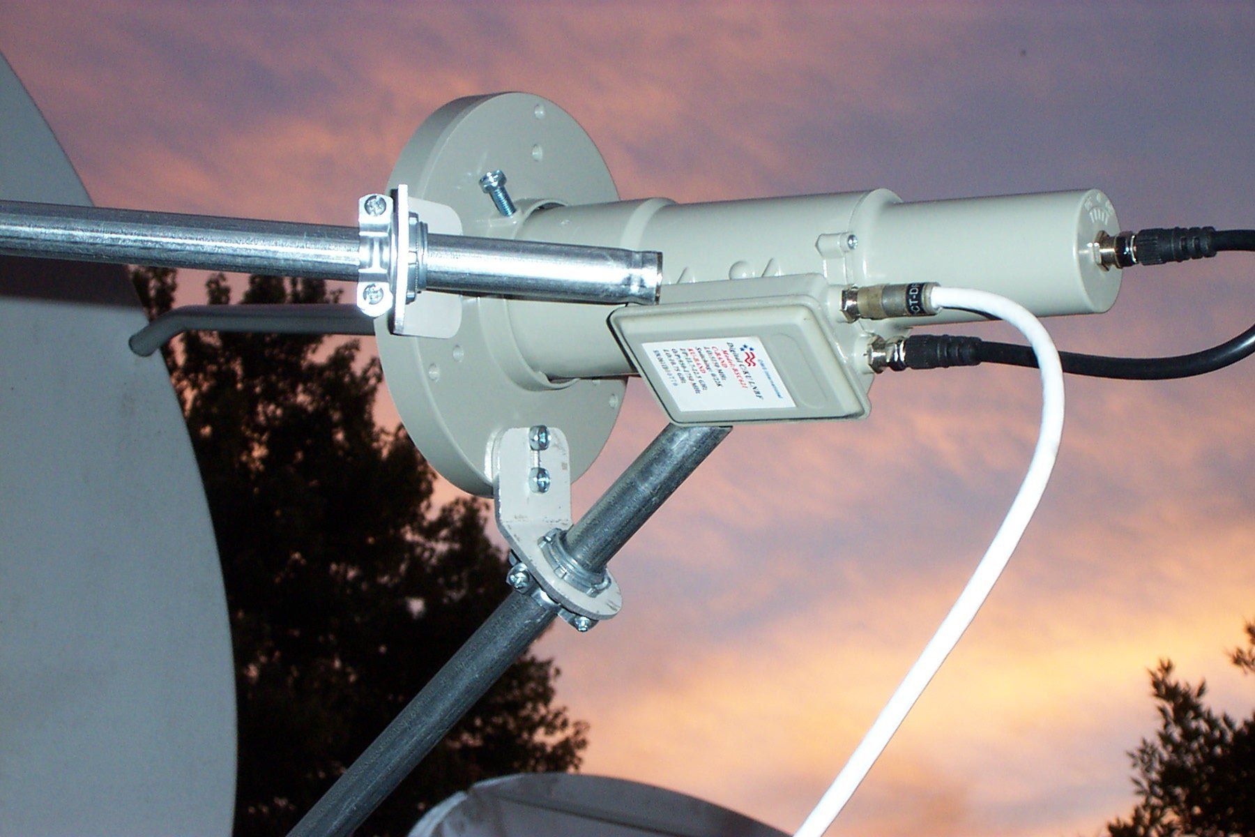

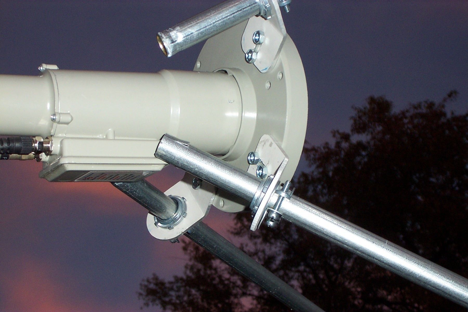

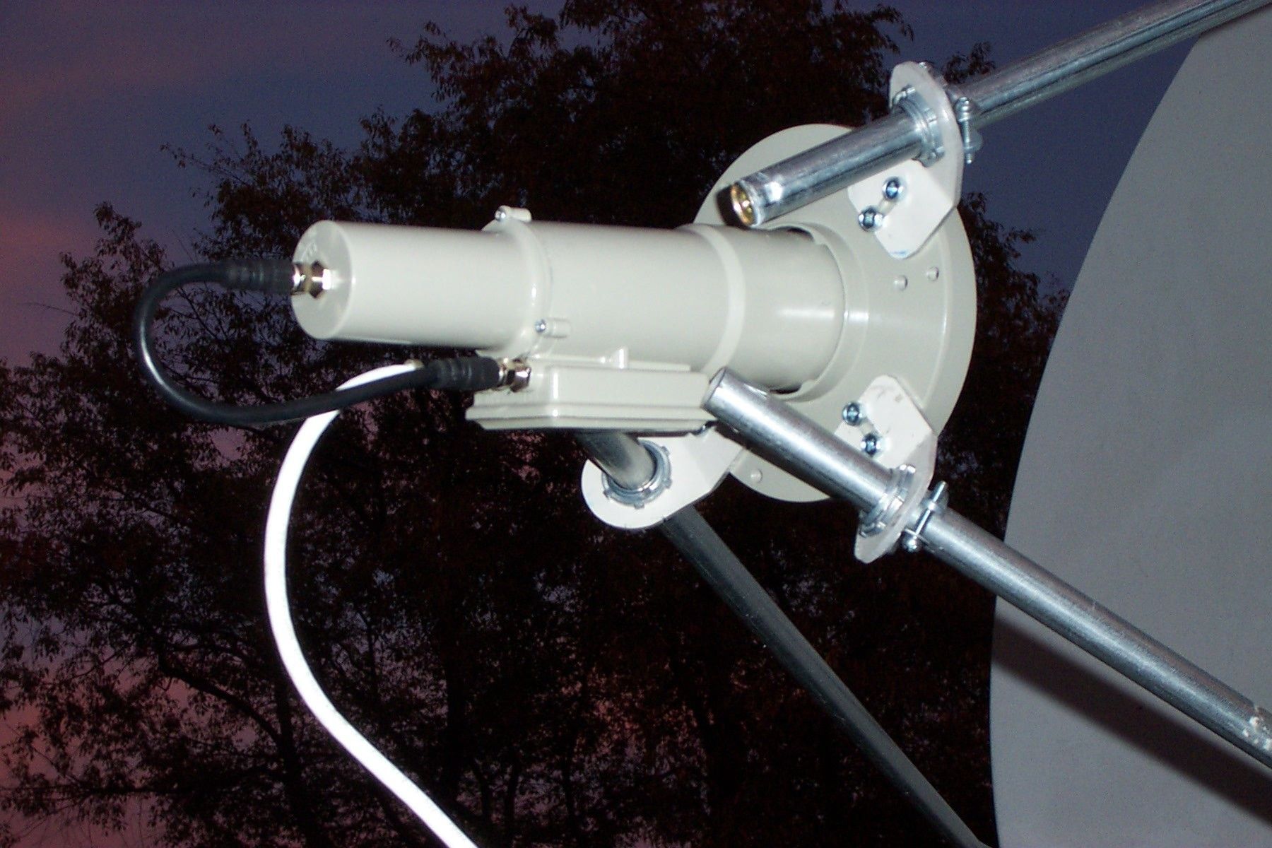

I have gotten excellent results using a C/KU LNBF on my 1.2m CM dish.
When I first installed the C/KU LNBF my KU reception was a lot worse than when I only had the KU LNBF installed. In fact, it was so bad that I uninstalled the C/KU LNBF and reinstalled the KU LNBF.
However, I then decided to give it another shot and reinstalled the C/KU LNBF and I am happy I did. With a lot of tweaking I now receive KU about 95% as good as when I used the KU lNBF alone. Hopefully with some more minor tweaking I will be able to receive KU 100% as good as when I had only the KU LNBF installed.
