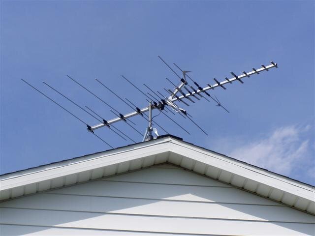

I just installed an hd7082 see picture and its about 2 feet shorter than the hd7084p. I have had the best results with the winegards and have tried them all.
