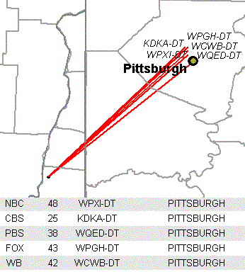

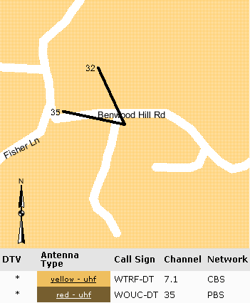

In my constant quest to have my channel map changed to Pittsburgh with no results I once again called VOOM. The CSR and I discoved that AntennaWeb has my house in the wrong place by 1/2 mile and even when placed in the right spot the Pittsburgh channels I actually receive don't show up and the channels that do show up I don't receive. Thus VOOM seemed reluctant to change my channel map :no
However when I explained that last year AntennaWeb was correct and had the right stations, and that Titan TV showed the correct stations the CSR expedited the request again.
Attached are the AntennaWeb and Titan TV results when placed at my correct location. There is a big difference between the two with AntennaWeb being the incorrect results.

Antennaweb.org has become very conservative in their digital maps. I am working on your mapping bryan. I hope to have it resolve even if antennaweb.org is incorrect.
Thank's Sean. Since VOOM relies heavily on AntennaWeb, major mistakes like this could explain why so many people have problems with their locals. I did notice if I did analog only on AntennaWeb it was way too liberal and showed stations so far away they only come in during tropo enhancement.
Titan TV seems to be more accurate, but noticed it can be too liberal. It's run by Decision Mark, the same database used by D* & E* to determine distant egibility.
