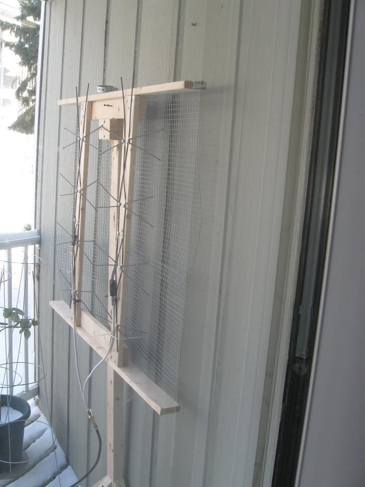

Here's the antenna I was using before the C2. Is there some terrible flaw in mine to make the C2 work so much better?
Four bow ties times two, with equal lengths RG-6 going to a combiner. Seven-inch elements since I'm not concerned about channels 10 or 11 (ABC 8.1 and NBC 22.1). The reflector is around 3-4" from the bow ties.

Mass production optomizes reception, home construction rarely works as well as optomized mass production. You were quite happy with your home design/construction untill you compared it to a manufactured product. Eagle Aspen Pro-Brand DTV2BUHF was used in this area by Directv as their TV antenna, I looked at it as a cheap 2 bay they used to quiet customers where they couldn't sell Dallas stations. We were in the wrong DMA. I tried it and was shocked at how well it worked for the price. No it wasn't great for ch 8 ABC out of Dallas but at 60 miles it works well on UHF.

Flaws:
Using wood to mount the elements
Mesh reflector is not a consistent distance from elements
Using two baluns kills a dB or two of gain
The picture makes it look like the length of one balun is shorter on left side. If so then some loss there.
Connector for RG-6 is touching antenna on right side.
I don't see a point to building an 8 bay unless you are a perfectionist. Its too easy to wipe out the 2.5 dB or so in gain over the 4 bay. I built a 4 bay for my parents based on the Mclapp design and it gets VHF at 25 miles and UHF at 50 miles in an attic.
