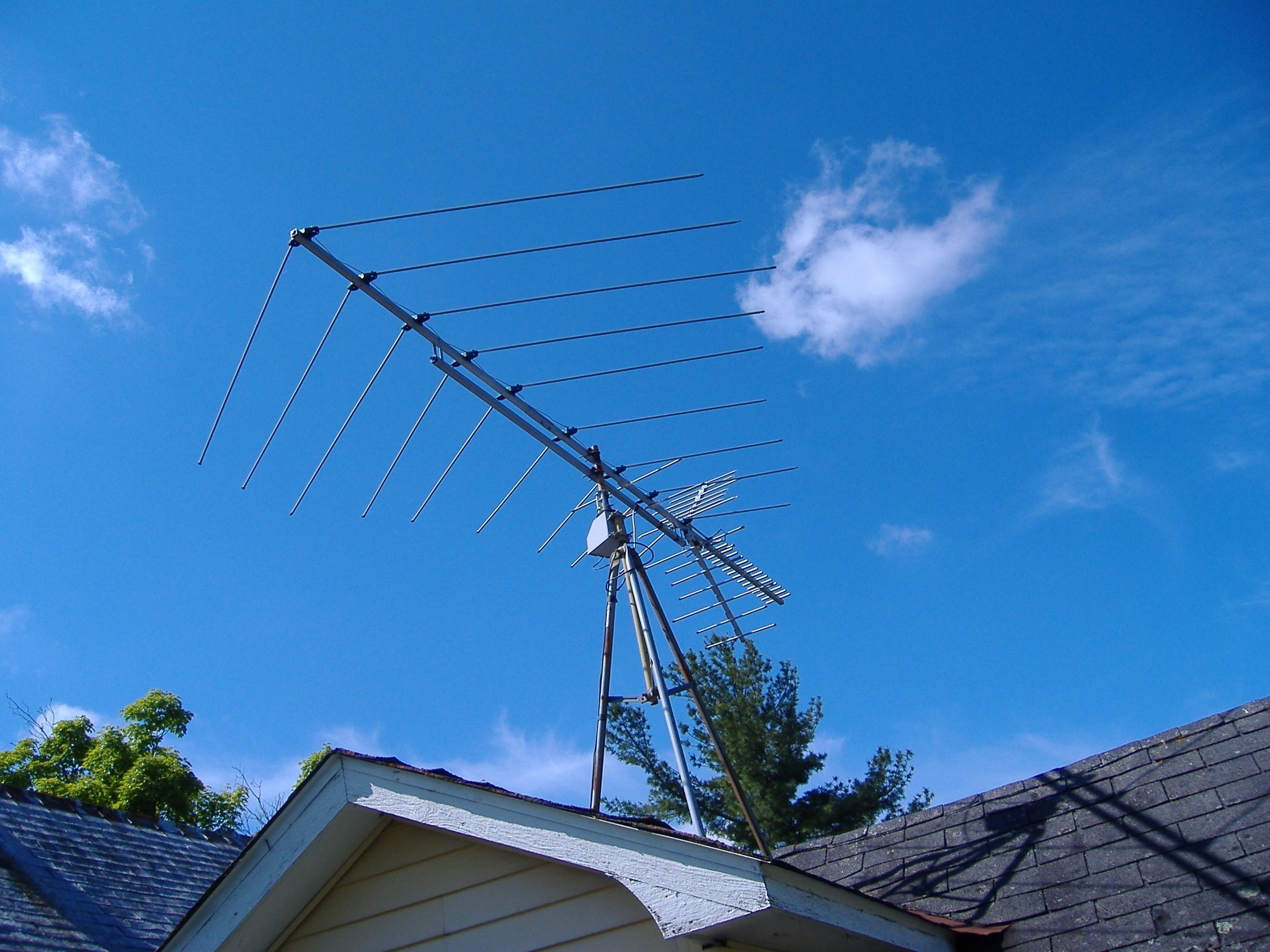

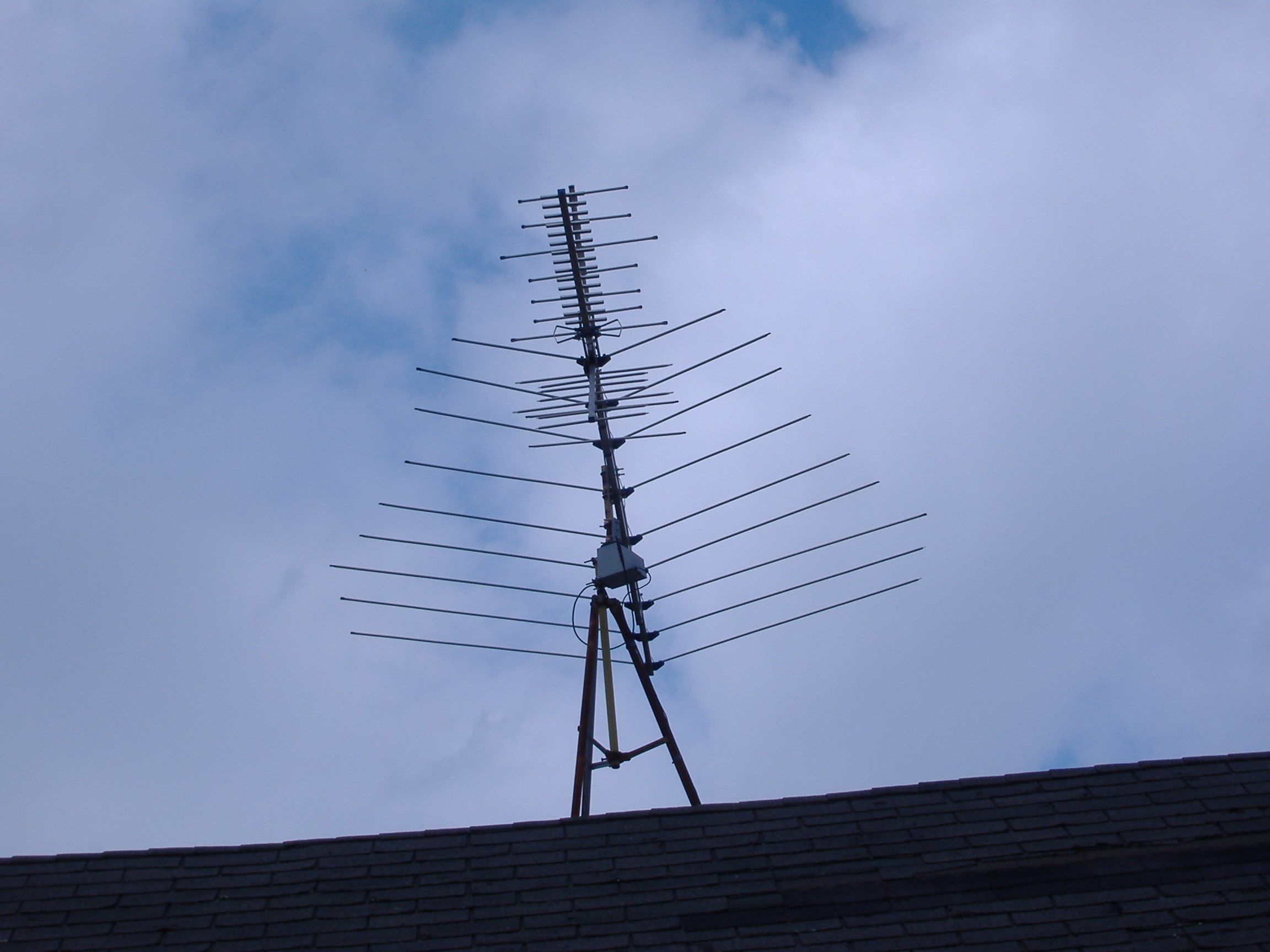

The specs are comparable to ChannelMaster's 7777. It's $32.99. I'm getting all the locals available on the US side, some of the Canadian DTV stations that are available come in at night sometimes, I would like to get them to come in all the time if possible. I have had a long range antenna with a rotor on the roof for many years, I believe it came from Radio Shack, unsure if it was their brand or not. It probably would do me good to update my coax as well.

Having the antenna mounted on your roof, you might not have enough elevation to get the Canadian stations. The Canadian digital stations are extremely low powered. The UHF stations need a line of sight for good signal reception.
