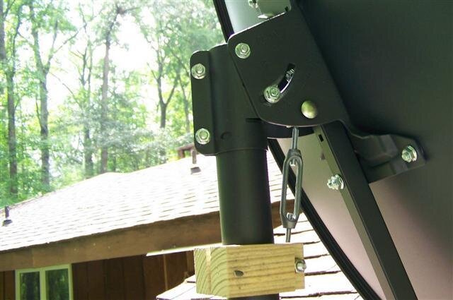

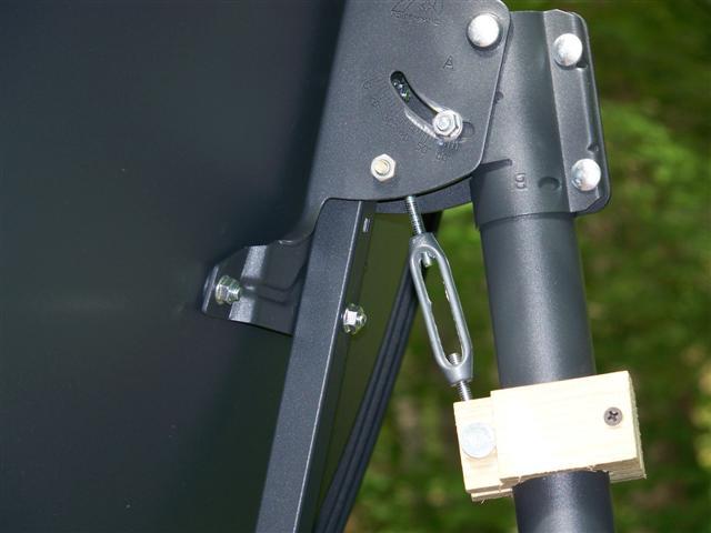

My modification was to place a carriage screw in the unused holes on the elevation bracket. I used nuts as spacers to center one end of a turnbuckle on the screw. The other end of the turnbuckle is connected to a bracket clamped to the post. In principle it looks like it might work. I just wondered if anyone else had tried anything for finr tweaking?

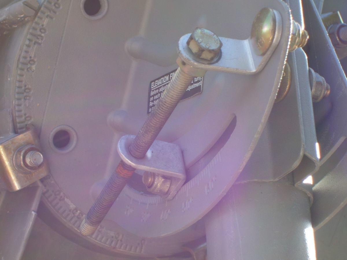

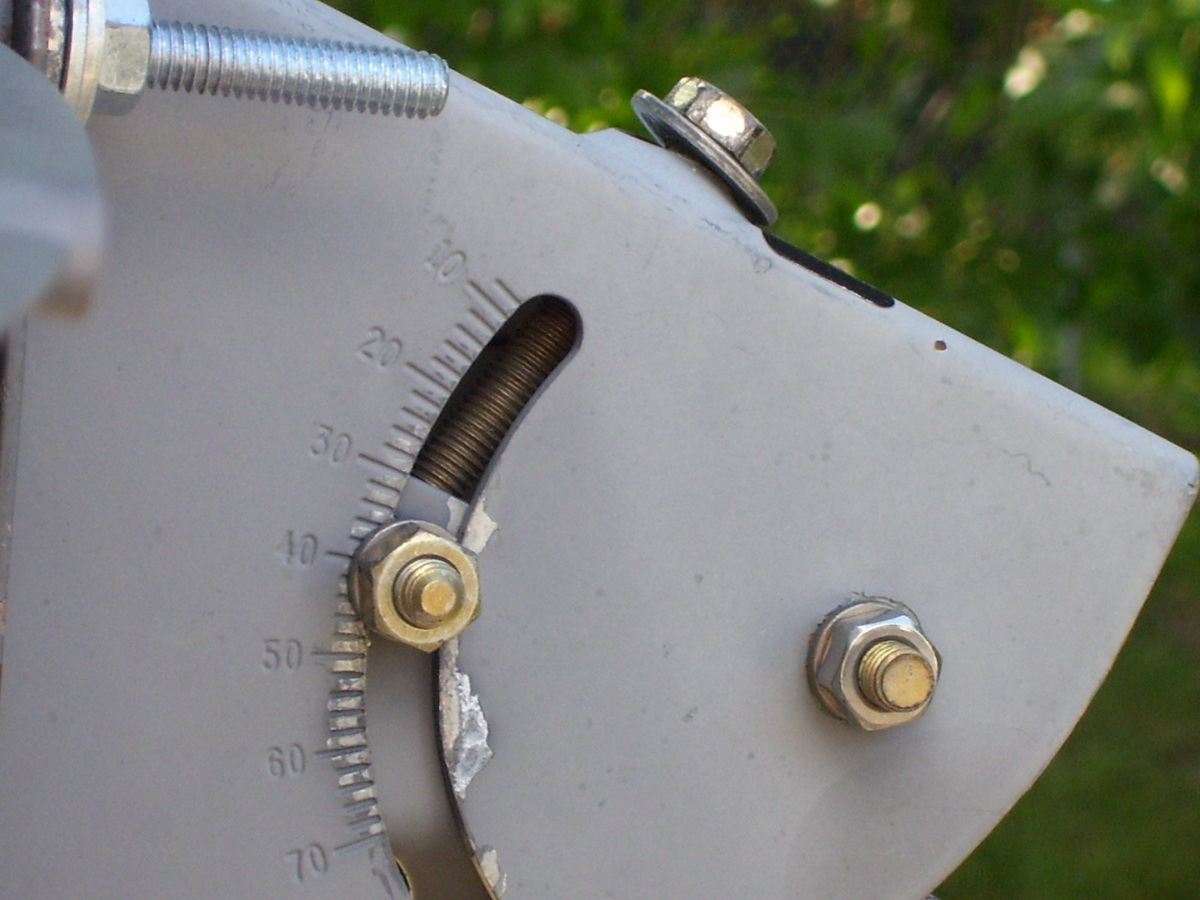

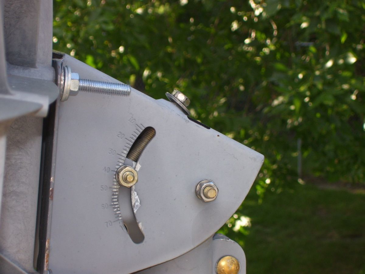

Channelmaster dishes had that fine tune bolt. My Starchoice & Primestar dishes have them. One handed elevation changing...kicks major butt :)
put a 1/2" socket on the top and turn to raise & lower the dish

Here is what I was talking about.
First is a Starchoice dish
2nd is a Primestar dish

Back to the drawing board! The mod works but the angle of the turnbuckle is too near vertical. If the elevation is not securely locked any attempt to raise elevation jacks the post clamp and the whole works up the post. I am thinking for the next phase to use a bracket that mounts to the post clamp instead of the post. Maybe pulling across the top of the clamp rather than having the turnbuckle in compression as now.
