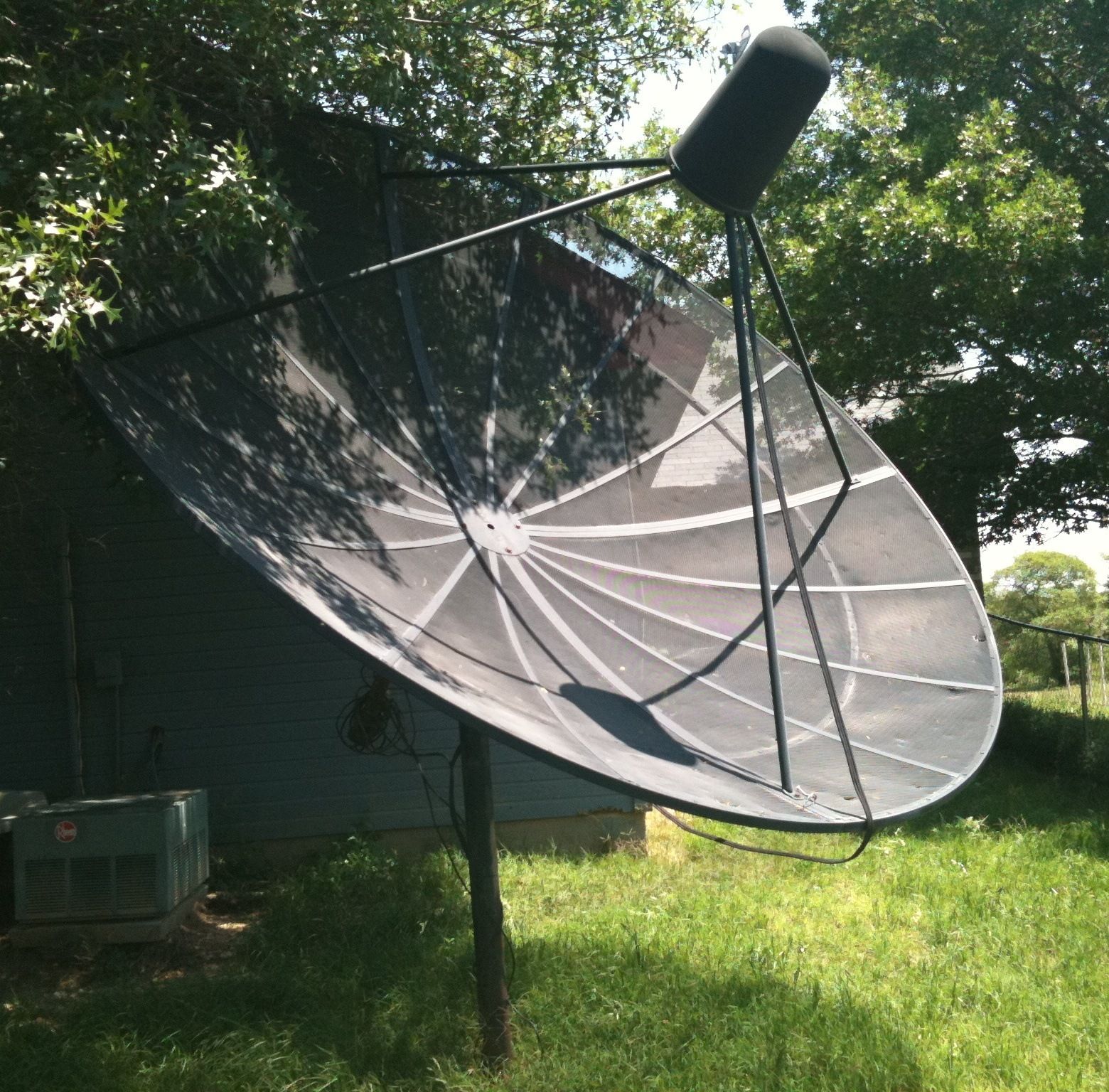

Here is a pic of the dish. I don't have it yet, going to get it Saturday. The guy is giving it away if I will take it down.IMG_1069.JPG
It does have some dings in it, will that hurt anything?
Will I have to take it completely apart to transport it?

....Here is a pic of the dish. I don't have it yet, going to get it Saturday. The guy is giving it away if I will take it down.....Will I have to take it completely apart to transport it?....
Looks like you found a nice one. Have fun with the removal. Be careful and safe.
You are going to hear more than once, but SURE you have the pole you install it on at your site as plumb as possible when you concrete it in. That will prevent more problems than you can ever guess.

how far you travelling with it? id recommend removing the reflector from the polar mount for transport. the reflector weighs a fraction of the mount and actuator. carrying a dish with that weight hanging off the bottom isnt a good thing. otherwise it shouldnt take more than an hour to load it on a truck provided you dont have to fight seized bolts. im picking up 2 dishes tomorrow as well. hoping for good weather. good luck with your first install.

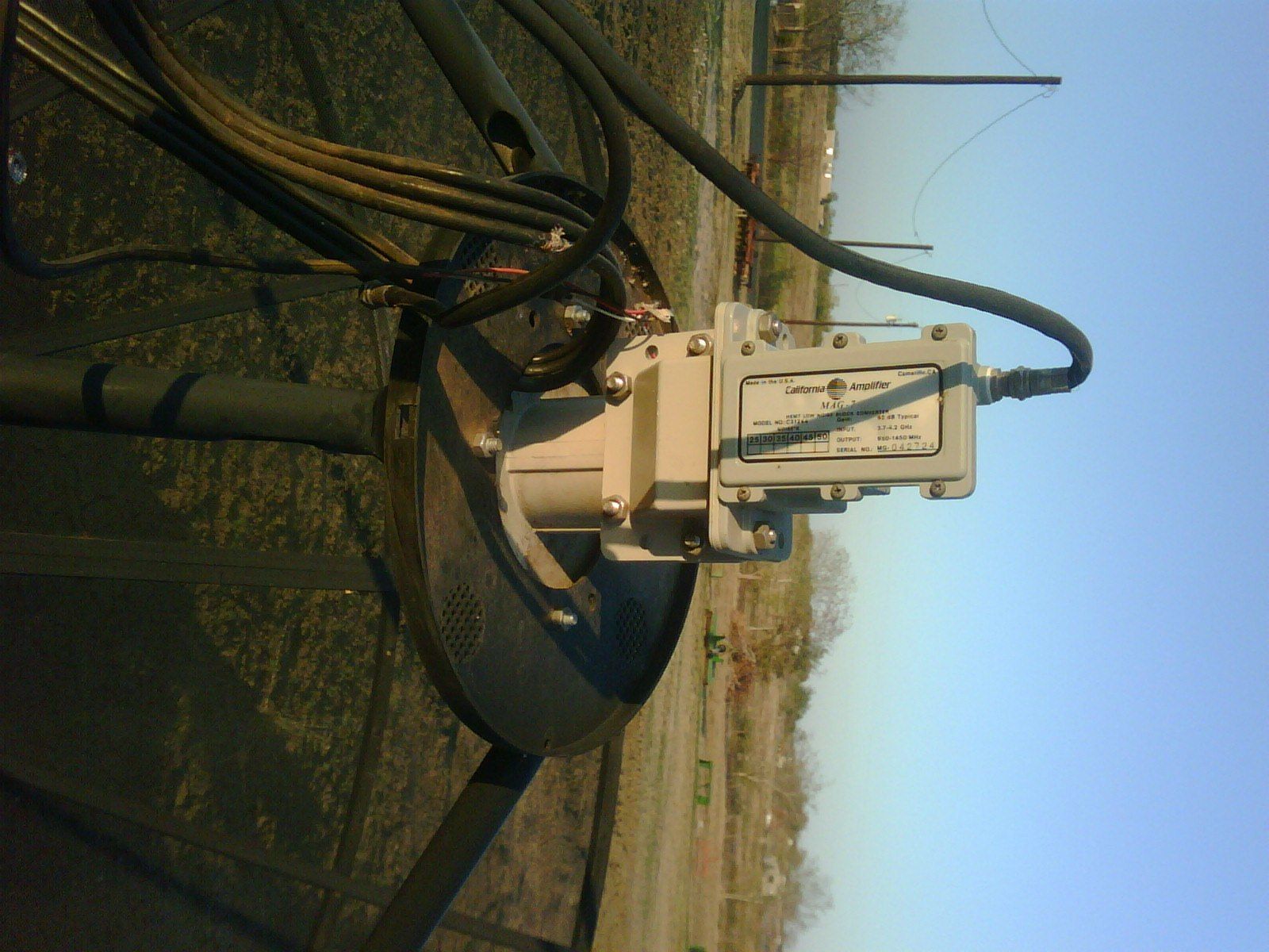

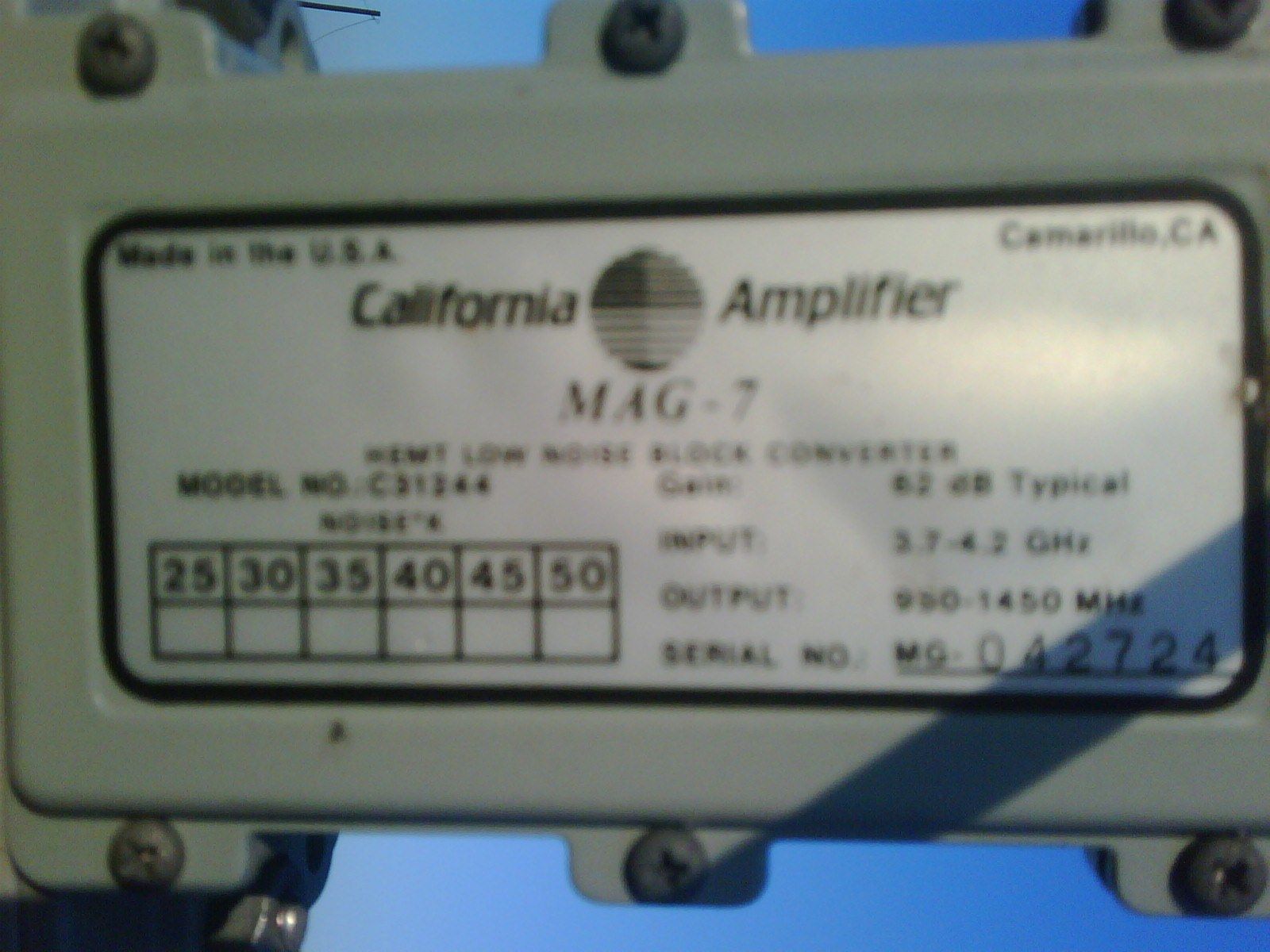

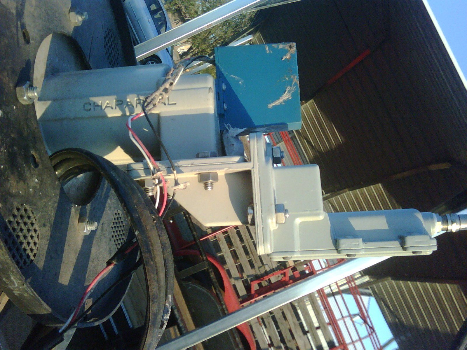

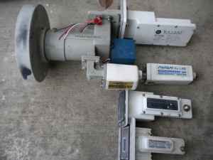

Got the dish Saturday and it was about 200 mile round trip. The guy said it was an 8', but it is a 10' Unimesh. He said it does C and Ku, I don't know but I took the cover off so I could show you guys pics.

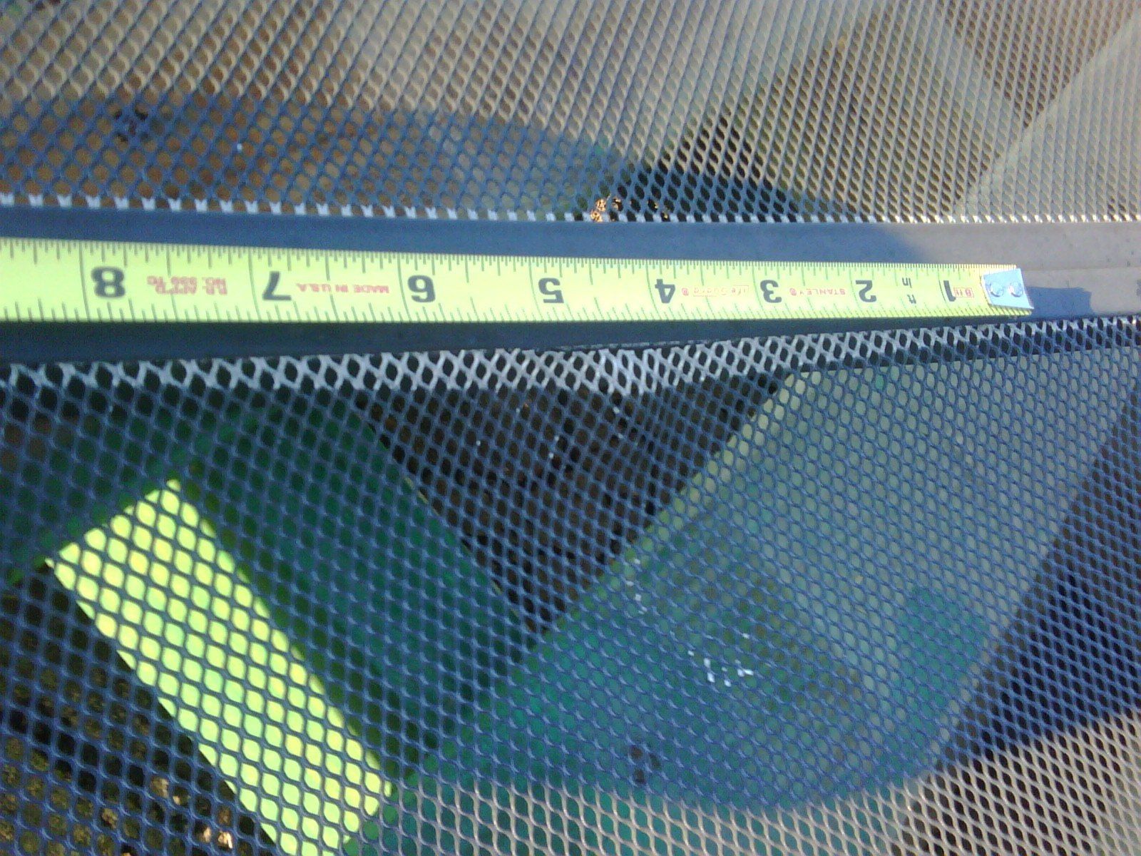

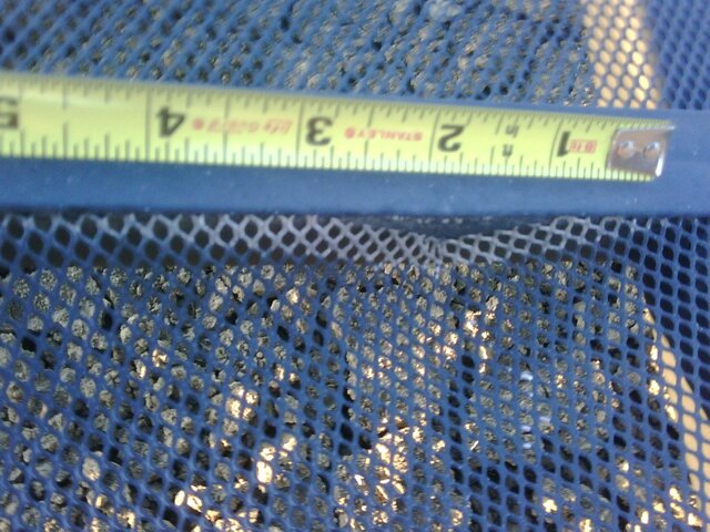

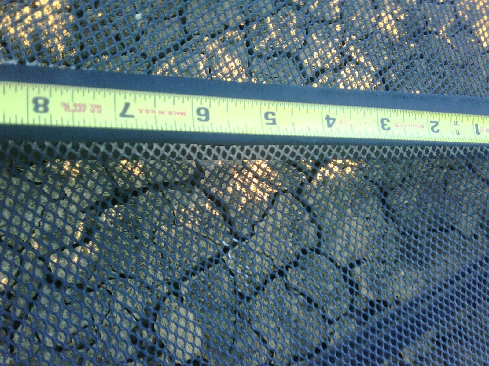

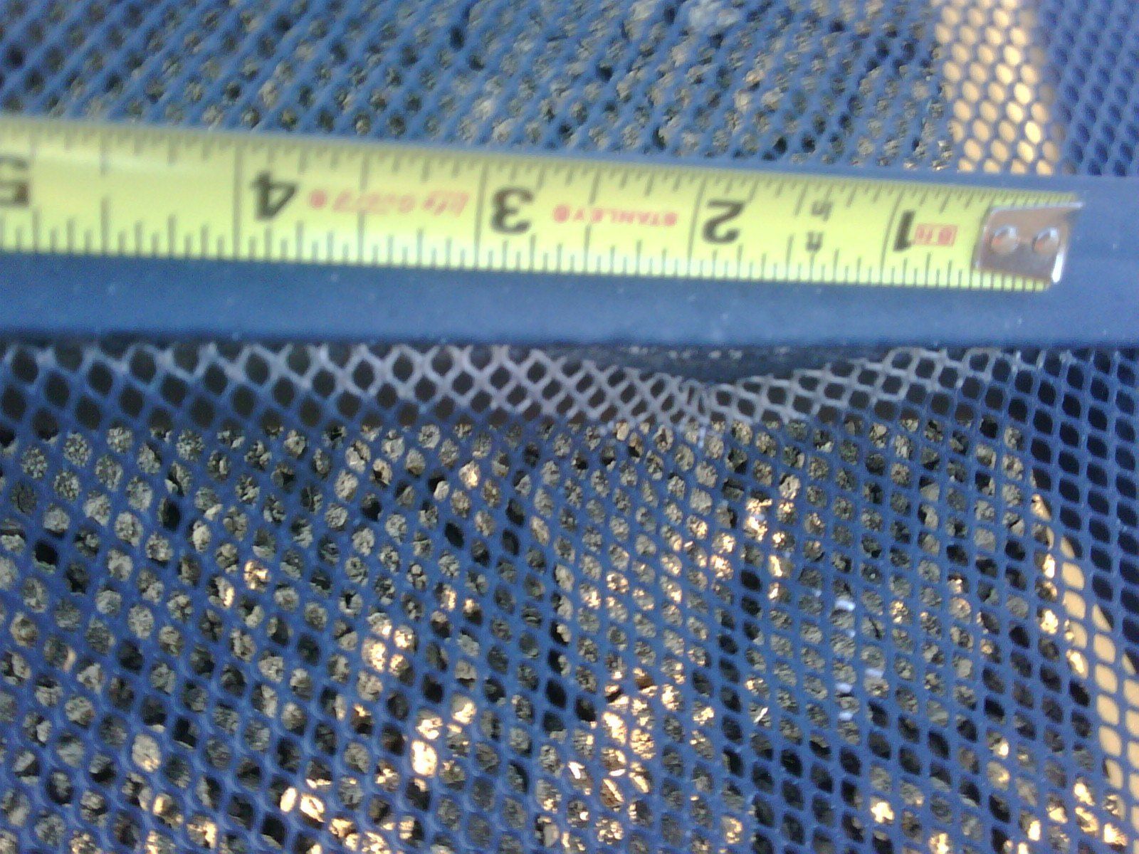

I am attaching some pics, that show the hail damage on the lower part of the dish. There is a "v" shaped tear, about 3" long. There are other dings and some creases. These are in the pics so you can see the length. Can I bend these back? Can I replace these sections? Do I leave them and try to get signal first?

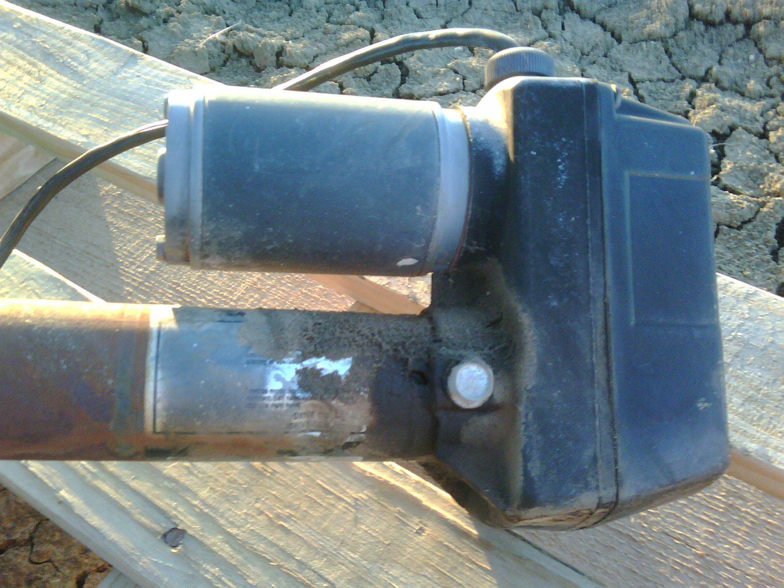

It also came with a Toshiba TRX-2200. I powered it up and the LCD came on, guess I will find out if it works when I get everything hooked up. It also had like a ribbon cable that was 4 large cables together. 1 coax to the motor, 1 coax to the lnb(?), 1 coax not connected to anything, 1 multi-wire cable to the blue box(?). Will I need to get this same type of cable to set it back up?
So is it worth keeping and trying, or should I just kick it to the curb? I think that all the questions I have. Thanks again.

Little tears like that in a 10' won't make much difference. You can see how the mesh slides into that channel, and maybe with some loosening of some bolts you can slide that back into place, take a hammer and flat piece of metal if you want to straighten out the dings. A little fine wire will let you mend the small tears back. As long as the dish still has good overall shape it should do a good job.
That's a c-band only feedhorn in the picture though, the unused coax you mentioned would have been used to power a ku-band lnb.
You can go with that and just tinker with c-band for awhile, or buy yourself a c/ku feedhorn with polarotor (that blue box controls polarity of the signals). Or you can get yourself a c/ku lnbf, won't need that Toshiba to control polarity, but you will need it to move the dish, unless you buy one of those gbox actuator controllers. That's a nice analog receiver there too, but there's not a lot of analog video left up there to see. See how this hobby works, now? One part begets another lol. That looks like the makings of a good beginning though. Good find.
edit: Added: the other questions, about the cable, I didn't address. YOu'll need a run of RG6 to power the lnb, if you didn't get the ribbon cable with the dish. If you use the analog receiver to power the lnb and polarotor, you'll need wire to operate the polarity motor too, you can buy sprinkler wire that'll handle that 5volts. May be able to use the same thing to power the dish-actuator motor. I think that's what I used on my last one that I rigged from parts. That ribbon cable can still be had, but I don't recall from where right off. Hope this helps get you started. Did you get the pole to put the dish on? If not, you'll need a 3.5" OD pipe to plant it.

you need to check if the actuator is the heavy duty one from sadoun because you have a 10' dish. the old actuator if it has a reostat instead of the reed relay will still work with the gbox. it just won't go to the position automatically. with my old heavy duty actuator i had to count the pulses from satellite to satellite but worked ok. now i got the reed switch actuator and works well. dmx741 works well on my 6' dish. the dmx741 gets it's power through the rg6. you only need one run with the dmx741 because it has a switch built in to go from c band to k band. my post still has the cement on it. my post hole digger was big enough to make a hole big enough. charlie
