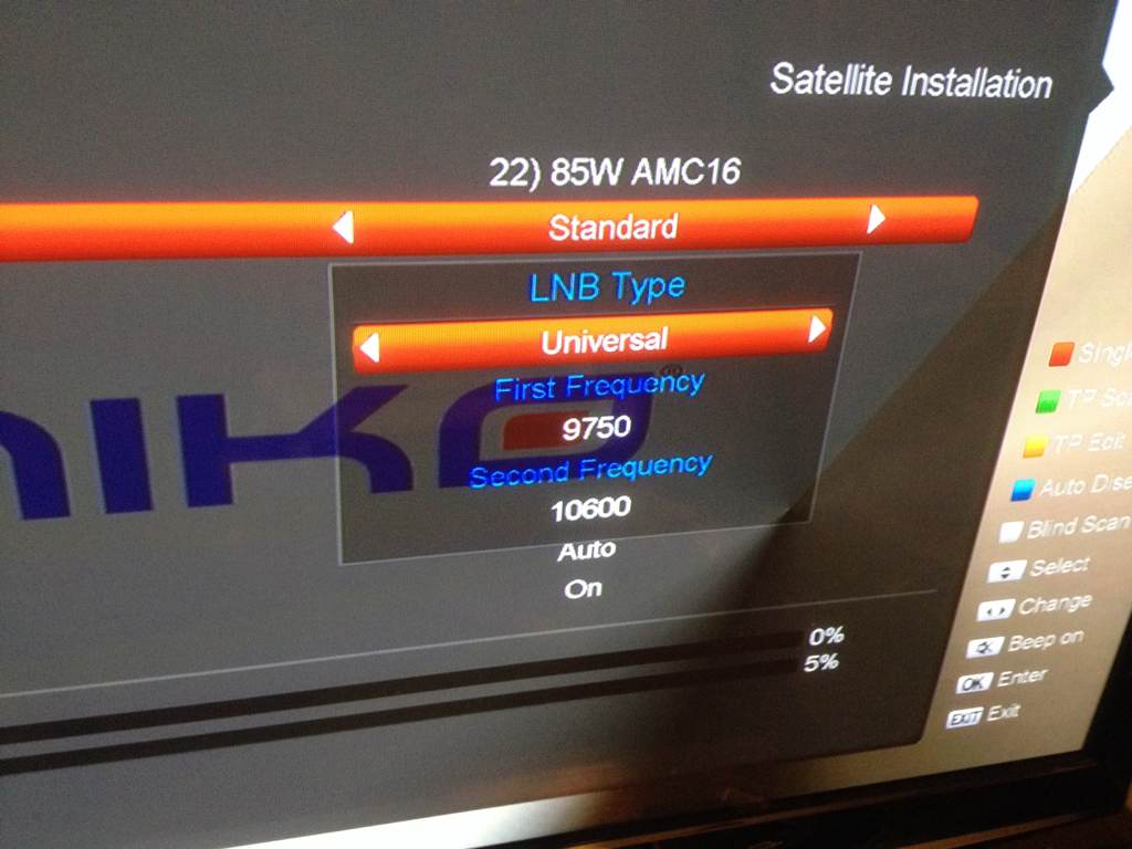

Does your lnbf setting look like this?
And I believe your old lnbf was working the day you removed and replaced with the l104?
Was the older units working before you switched out, I mean like recently? I'd say it is a LO not set right. Wally showed you where it needs to be.
Did you set your long and lat, in the new Mini?
Thank you, gentlemen, for the information. Changing the LO frequency got the bars there. And I was able to scan G19. Now, do you recommend USALS or DiSEqC for the positioner setting? The video narrator used USALS so I tried it. And I did set the local longitude and latitude. Moving to 125, though, the dish stopped at 121. Finally (for this post), are all the FTA transponders I'd want already programmed into the Mini HD or do I need to add some to the various satellites? I'm going to work on re-peaking the dish this week, too. Again, I so appreciate your helpful replies. FTA for me is like the video version of shortwave radio. So many different cultures to explore.
