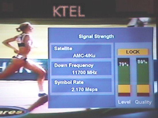

KTEL would be the channel to lock onto. It is the highest signal on AMC-4. Blows all the other ones off the scale.
Freq: 11700
SR: 2.170

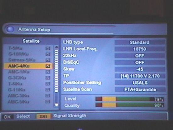

I just took a few screenshots off of my 2500A. But it sounds like PSB is right. You may need to adjust your pointing some more.

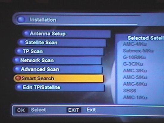

Check your menu for 'Smart Search'
MENU-INSTALLATION-SMART SEARCH (See search.jpg)
I included a picture of the antenna screen too. (antenna,jpg)
And the signal info for KTEL: (ktel.jpg)
