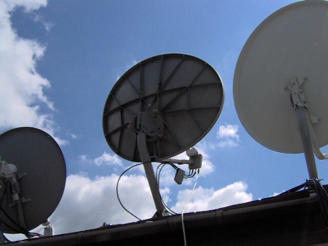

but those torridials can pick up a lot if you are careful. I don't have one and have never fooled with one, but saw some pics some others have posted that does have em... good grief. I think one guy has almost 13 satellites on one of those bigger tors!!!! Here's a thumbnail - can't remember who posted the original pic - kudos to you.

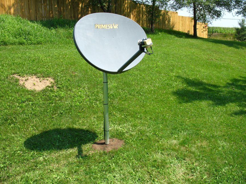

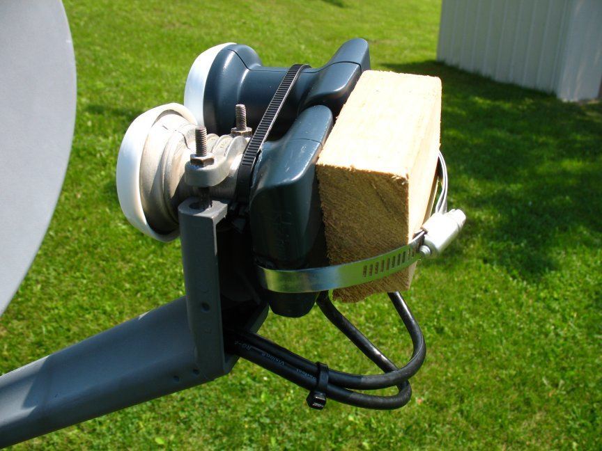

Check out a setup by a member here, he is picking up two Satellites IA5 and AMC4 with one dish... see the pictures attached
That is cool. Are those just standard FSS LNBs? I have a Primestar dish.
Thanks......
Thanks......
Those are Universal KU LNB's (what Gary Z posted)...the SC LNB uses a 22k switch for 2nd LNB
just got to wondering about that later on, if it was a SC and if they were dual lnb. I just got my hopes up thinking about hitting two satellites with one dish. But they have to be a dual LNB, or especially small LNBs connected together to do it, right? If you used 2 regular LNBs together, you are talking more like 9 degress apart, right?
depends on the LNB's...I can get 4 degrees apart with some of my LNB's...some are 5 or even 6 (depends on how big the "eye" is )

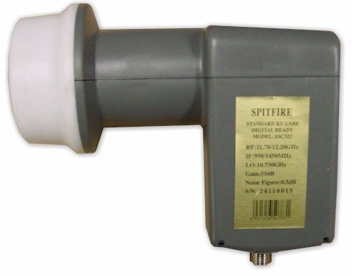

Does anyone know if by using 2 of the LNB's in the attached picture would work to get 4 degree space between AMC4/IA5 on a primestar dish?
possible...only issue is the "bump" where the eye meets the LNB (where the white meets the brown) actually hinders it.
But AMC4 is very strong so there is some room for error. :)
