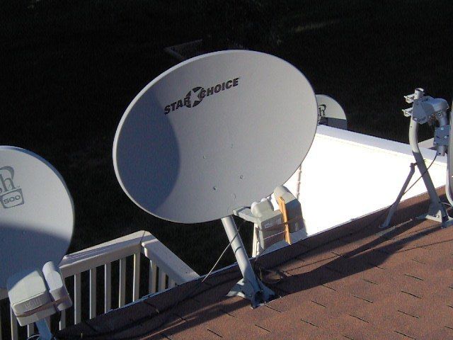

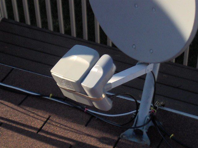

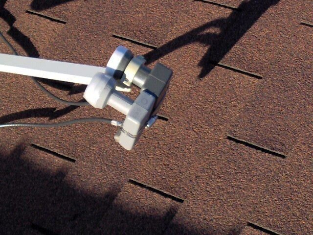

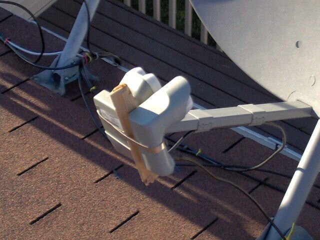

What KU LNB do you have? It wont throw off the positioning (Ive done this on a few asetups). Just make sure to turn off the receiver (with switch on back) when adding/removing the switch
few examples. Last one is a KU/DBS setup

yes you will have to redo the settings for the DBS slot since its offset. In the above picture, for N1 its at about 96/97 (just like jh98 mentioned) :)

yeah that was before I biffed it on the roof that day. I thought I broke the arm & LNB but I just knocked it out of alignment....10 minutes later we were back
and that picture is long before we had snow :)
