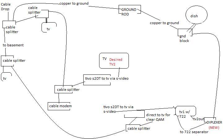

Well, I've been installed for about a month now, and have been using my 722 as single-mode for the PiP and such. We've been thinking about it, and just realized maybe it would be nice to use the TV2 on another TV. The problem is, we have kind of an odd route, with several splitters, TV's and a cable modem in use. It's kind of hard to explain briefly in text, but the attached layout diagram is an accurate depiction, so I'll just let everyone look at that to save time.
As you can see from the layout diagram, I've already marked where the first diplexer goes, with the wall line, the 722 in, and the TV2 RF Out all connected to it. I'm not sure where the SECOND diplexer goes, or WHICH TYPE of diplexer I need for both of these, since I know some pass power and some don't and other considerations - especially since I have a cable modem involved.
Incidentially, my ground block has 2 lines into it, but only 1 out - what's the second one for? Is it just in case I add another receiver later?
I know I need to run new RG-6 between the first cable splitter from the drop and the satellite ground block. My question is just - since these locations are actually physically separate (about 10-15 feet apart, but it's not a problem to run RG-6), how do I do the diplexer? I'm kind of confusing myself about it.
I'm guessing I put the second diplexer near the ground block, with the line from TV, line from dish (that is, hooked up to the ground block), and line to cable splitter all hooked up? The line to the cable splitter would then be put in a normal cable splitter in reverse, with the cable drop fed into the other port and a short piece connecting that splitter with the existing "first cable splitter" input port?
Oh, and both TV1 and TV2 have TiVo S2's fed off this line (backup to sat, we have it because we have internet). Both Tivos output to TV via s-video - I see no reason why this should impact the setup, but want to make sure. The entire setup is grounded to the same grounding rod setup, from both the dish and cable splitter, so I don't anticipate a ground loop problem.

2nd feed at ground block is a spare
2nd diplexer inserts at ground block, tv, rf side is new run to 2nd tv
diplexer must be rated to 2250 MHZ
From Your drawing the cable splitters have Nothing to do with the 722 feed or the backfeed. Goodluck

Thanks for the info, guys - I guess I just need to worry about my diplexers, and the cable splitters aren't an issue. Hopefully the signal strength on everything is strong enough to make all this work!
I understand how splitters/diplexers work in general, I was just a bit concerned that my particular setup might cause me to have special concerns. Since that's not the case, I'll just get two diplexers online that do 5-2150 and pass DC on one side, measure for some RG-6 and then hook it all up and hope it works...

I know straight coax is an option - however, that's just not happening with my house, since TV1 and TV2 are at opposite ends! I think the solution I worked out with help from you guys will be fine - I've ordered the diplexers and some good outdoor cable and will probably post back when I've done the install.
