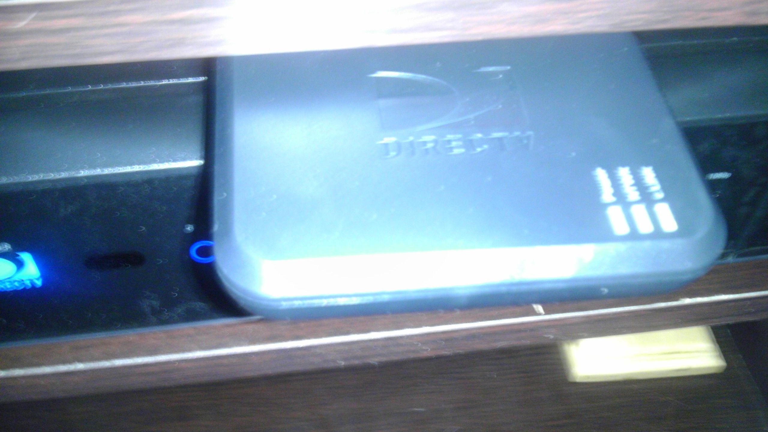

I got this little box w/ a HR34, HR24 and a H25. What is it? Im still learning!:D

Thanks and without the box. I would need a network connection at every receiver location?
I'm not sure,couldn't he just have ethernet connection to the HR34 & his HR24 & H25 receiver would receive internet connection from the HR34 coaxially? Also remember,he can only receive internet connection coaxially for his H25 because it has no ethernet connection.
